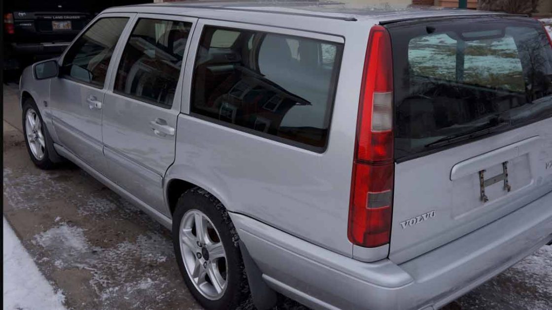

MVS Forum member HWG09 asks how to tell if his ’99 V70 R has a burnt valve, and what follows is literally pages of discussion on how to diagnose and treat burnt valve conditions.
