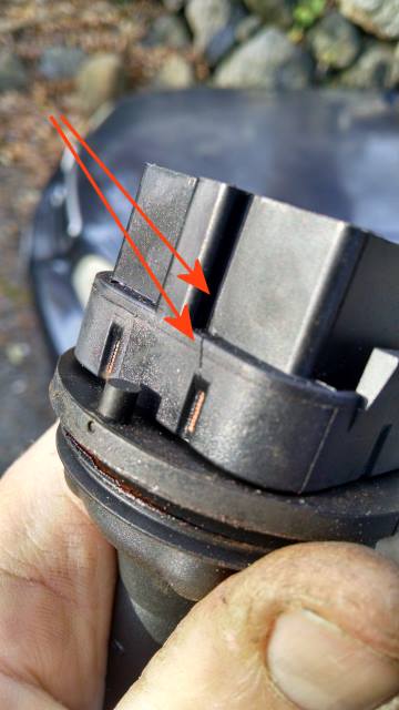

MVS Volvo Forums member MarcM’s S60 was misbehaving at low RPMs… P2 coil resistance measurements save the day. Ended up being coil #3.

I just started car to make my way on a 19.5 mile run. Idled a bit rough. Got about 4 miles and car started bucking and lost some power. Tranny kicked down a gear. CEL started flashing. Turned around and got it back to house.
