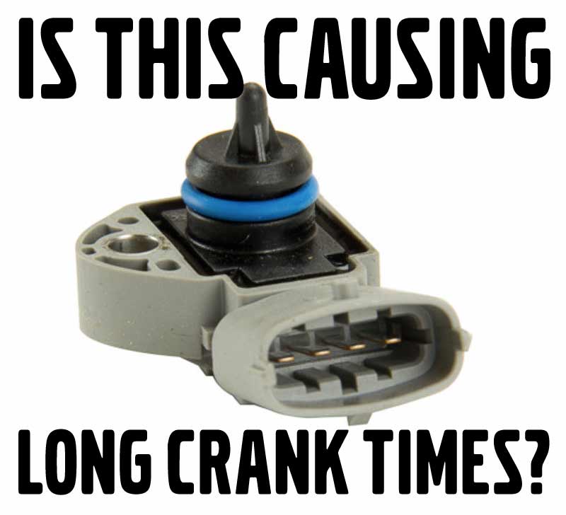

2008 XC70 owner mrscullini is troubleshooting long cranking on his wagon. “When the engine is shut off, it pretty quickly bleeds down to 0. trying to diagnose a hard cold start with excessive cranking.”
Bosch fuel pressure sensor Volvo 3.2
“Can somebody with vida/dice please provide observed fuel pressure numbers/specs at both the rail and overall system? I’m interested in readings both at idle and after engine shut down.”
