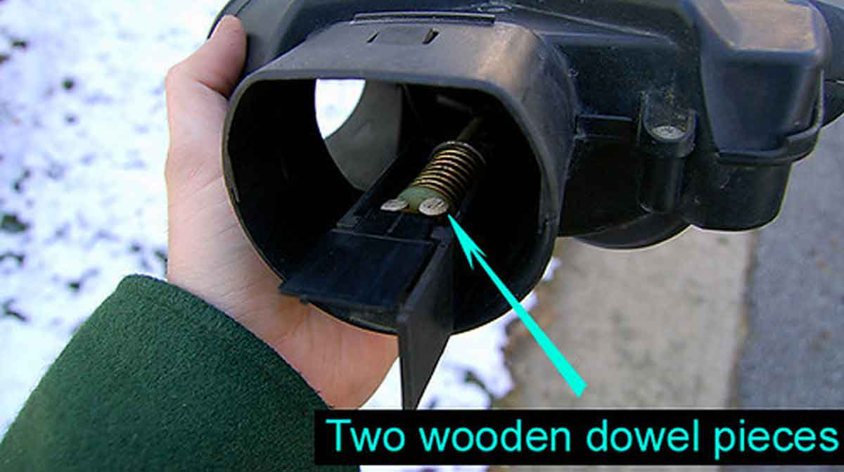

So I proceeded to take out the airbox thermostat. It was pretty easy, just open it up and at the bottom at where the air enters the box, there is a flat black plastic tab… pull it up and pull out the thermostat. Now you can’t just leave it like that, because when the thermostat is cold it sucks in hot air… so I took a small fuel clamp and shoved it between the spring (that the thermostat would push against) and the where the plastic tab was, acting as a spacer, so that it would push the valve open to the cold air side. I did this so that I can run the car with cold air while I figure out this thermostat.
