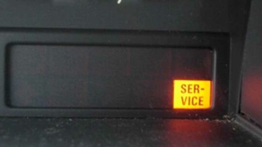

To start, the Ignition key must be in position II, engine not running. Open the hood. Locate the two diagnostic sockets just inboard of the washer fill cap. The “A” connector (shown above) has a jumper that is stored in the lid of the “A” diagnostic connector. The jumper is used for both diagnostic connectors.
What Codes You Can Get
Listed below is the information retrievable from the various connections.
  • A1 Transmission
  • B1 Climate Control
  • A2 Fuel System
  • B2 Cruise Control
  • A3 ABS
  • B5 SRS
  • A5 TCU (Transmission Control)
  • B6 Power Seat
  • A6 Ignition System
You Must Read All Codes Before Clearing
Turn the ignition off and then start the car, the check engine light should be out. It is always a good idea to check for codes, clear them and then drive the vehicle to see if they return before replacing parts. The transmission can ask the check engine light to be turned on, so if you try clearing A2 codes and they wont go away try reading the transmission (A1), clear them , and then go back to A2.
