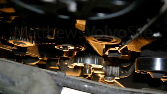

(1) Timing belt job (if this stuff craps out, the car is worthless): both rollers, timing belt, timing belt tensioner. See above for brands. Since it sounds like we need to consider total $ right now, let the water pump go but know that there is a chance it could start leaking. 140k is low miles though, for a factory pump. I would let it go and put it on the list for 210k. Don’t wait for the 5k more miles and hitting exactly the 140k interval, just do this job and cross it off the list.

And this is the timing belt kit…. http://www.fcpeuro.com/products/volvo-t … tbkit252wp

Timing:
I wouldn’t get that kit ($269) because of the GMB roller. Also, cam seals aren’t a standard part of the timing belt job although you can do the front ones during timing belt if you want to (usually only if they are leaking). Plus the Elring cam seals aren’t great, if you are going to replace them as preventive then buy the quality seals (SKF or Volvo). Rear cam seals no reason to change unless they are leaking. The oil pump seal (6842273) there is NO reason to touch unless you know it is leaking.
I’d save money on the seals and instead get
http://www.fcpeuro.com/products/volvo-t … kit252-oem $236)
plus a serpentine accessory belt (Conti, $22)
plus a water pump (Hepu, $60)
