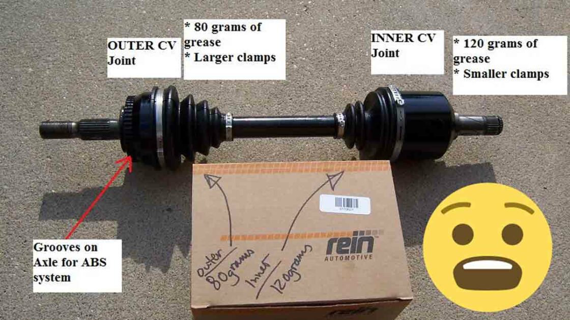

Once the Inner Joint comes out, Install the OUTER Boot first (apply grease on the small lip of the boot before installing, it makes it much easier to slide the rubber boot in, also grease prevents damage to rubber during installation!); then install the INNER Boot, also using grease.
7. INNER CV Joint:
* 120 grams of grease (Per Haynes Manual); but I used 160 grams.
* Larger clamps
8. OUTER CV Joint:
* 80 grams of grease (Per Haynes Manual); but I used 110 grams.
* Smaller clamps
