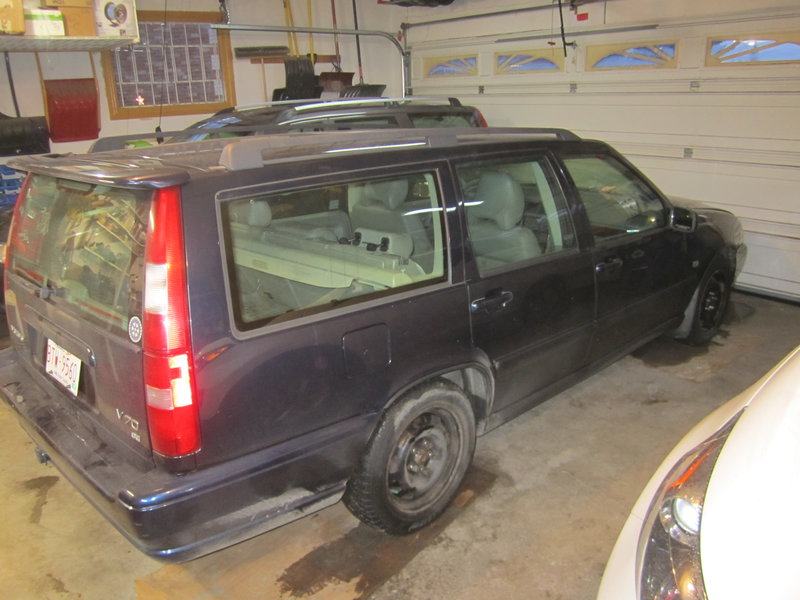

In frustration, I got back to a nice lady who had contacted me with a V70 base (she said it was a 99) that had the flashing orange arrow of doom, on the dash and an engine check light. After thinking about it more I told her to bring the car over and I’d run a diagnostic with my Dice unit to see what the problems were. The Dice unit connected up ok, but gave no codes, but also strangely no ID to the trans type. I didn’t think anymore about it as I rejected the car as having a bad trans. It turned out the car was a 2000 MY and has the 5 speed auto.
I decided to do some more checking as the fact the trans warning came on at the same time as the engine check light sounded familiar and good old MVS and all the wonderful helpers here identified a possible cause might be the PNP switch. I tired the ‘rowing’ but no different.
I explained that if the trans was bad, then the car was about $500 CDN as scrap due to cost of replacing the trans outweighed the car value as I can’t do the swap out. She decided to keep the car.
I spoke to my friend the foreman at the local dealer and explained the problem and he said to bring it in and they’d charge an hour diagnostic. I felt the $170 CDN was worth the risk and contacted the owner just before Christmas. She had changed her mind about keeping the car, and said it would be ok for me to take the car to the dealer to have it checked and I could buy it for $500. I agreed that I would pay for the diagnostic and if the trans was good, then I’d buy the car but if bad it went back home.
I arranged to take the car to the dealer and the explained the issue to the mechanic and he found the same issue of a comms issue with the TCU to the trans. He went ahead and pulled the ECU and TCU and found build up on the contacts (dirt and oxidation). He carefully cleaned the contacts with a Wurth product and cotton bud and re-fitted and removed a couple of times. He then got a communication link and pulled all codes and re-set. I had already identified that the trans was un-likely the issue when I drove it to the dealer as it was not in limp mode, and all gears were working which meant the PNP was an un-likely culprit.
Only other codes that were thrown were some ABS codes but no light was on, so possibly un-cleared old codes. Car ran fine on the way home and so far so good.
Drive did show a couple of other issues of strange handling (a strange pivoting from the rear) and brakes that were off at the rear (new front brakes).
I have been through the car from front to rear now and identified the problems and costs of parts and have offered the owner $800 CDN ($600 US). This is maybe a little high but she is a single mother with 2 older boys. She has been trying to keep the car going for the boys to use, but has been ripped off by repair shops. Have to admire a lady that takes her 2 boys to PnP for parts and then fits them herself!
She is delighted that I am buying the car, and I have now discovered it is an SE model with fog-lights, Homelink, tailgate spoiler, winter and summer tires, roof rails and roof box, and leather interior. Car needs love but now with my parts list of parts that have to be replaced and the nice-to-have list also (new rear springs to replace the sagging and rusted but not broken rears, front and rear engine mounts and a few other parts).
