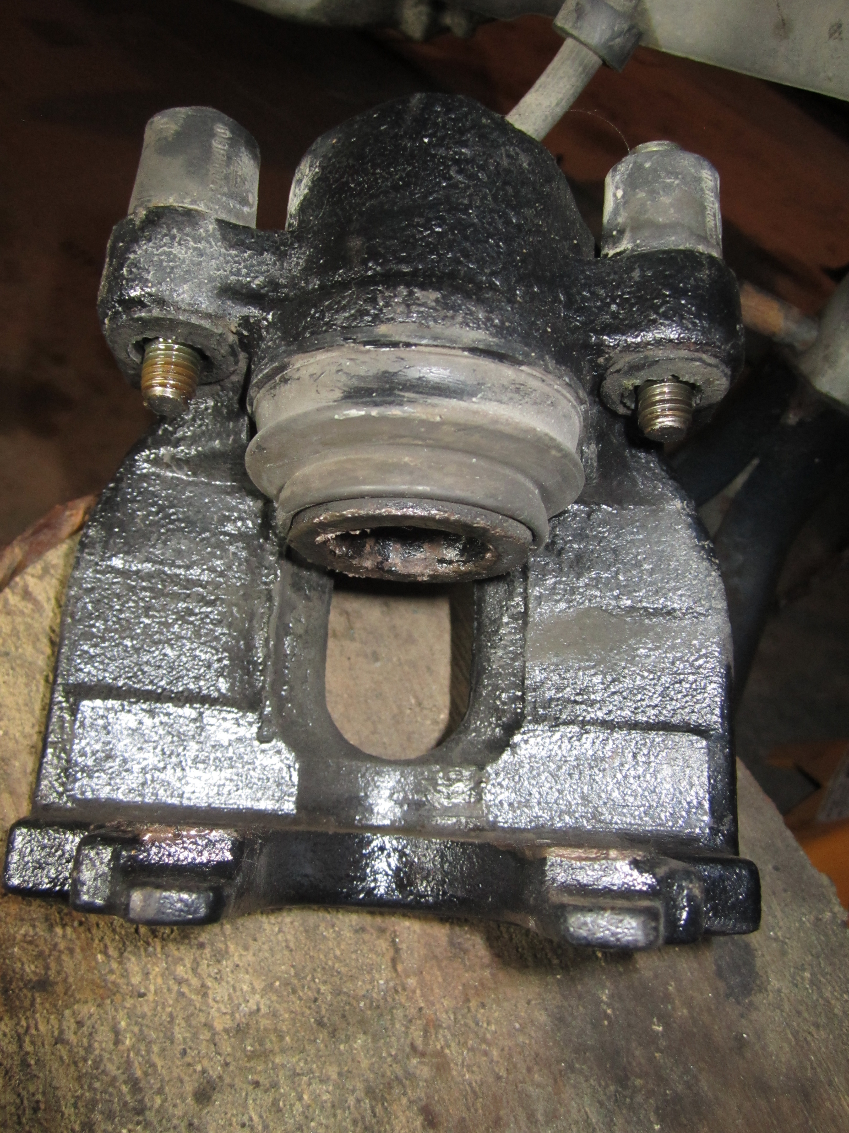

scot850 » Just so we are all on the same page, Blockpartie is correct in that to 2000 MY V70R had a 1 year rear caliper option. It looks like the front calipers we all know and love on our Volvos with a single piston and 2 slider pins. One brake pad is clipped into the piston with 3 spring clips.

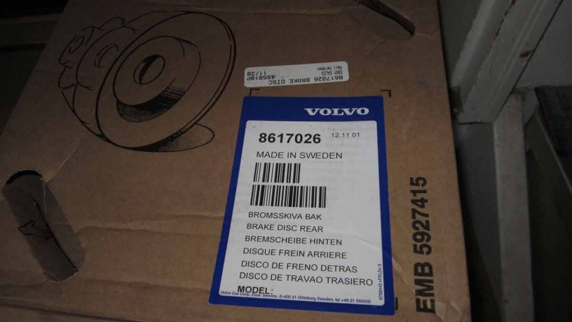

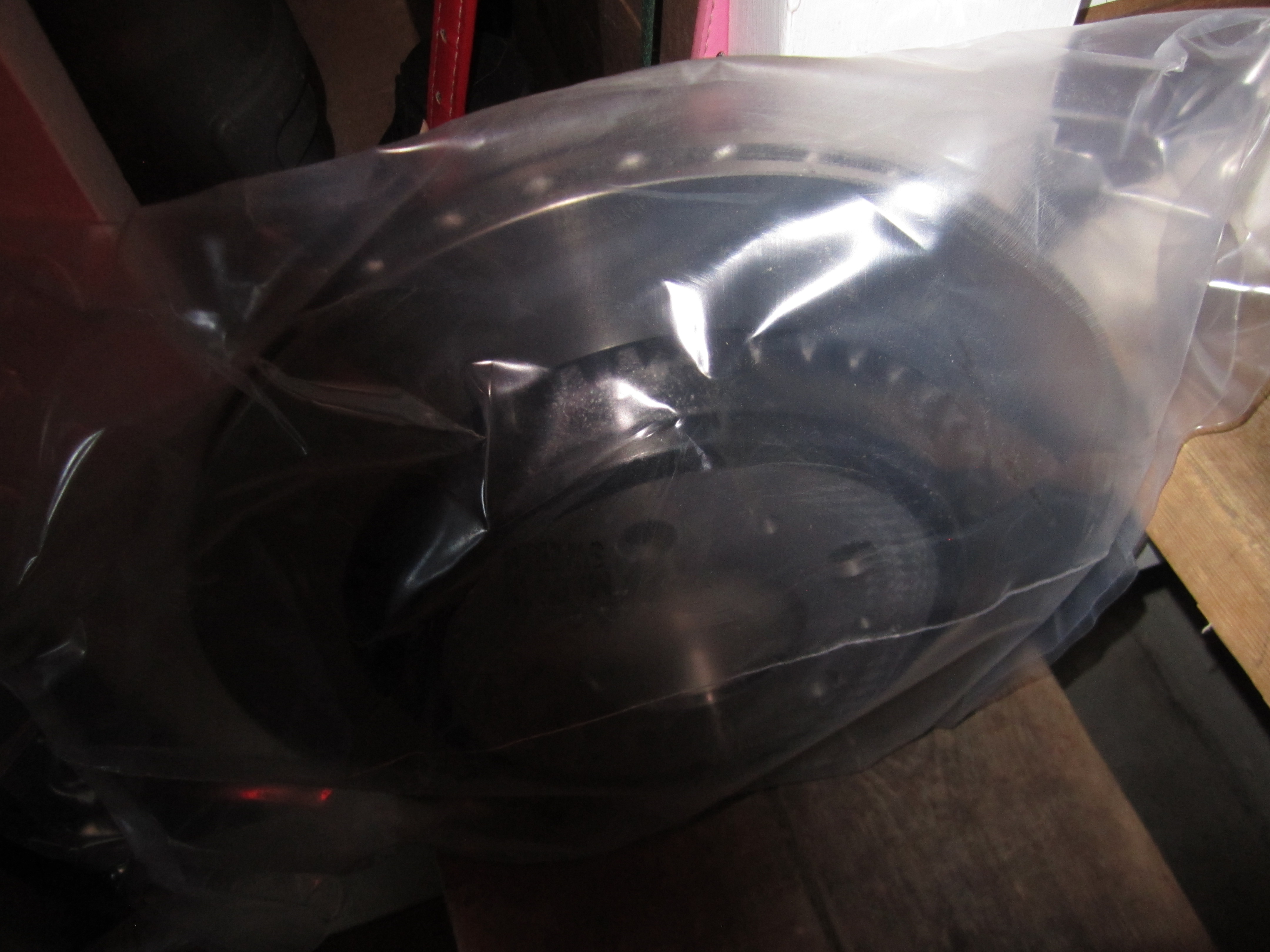

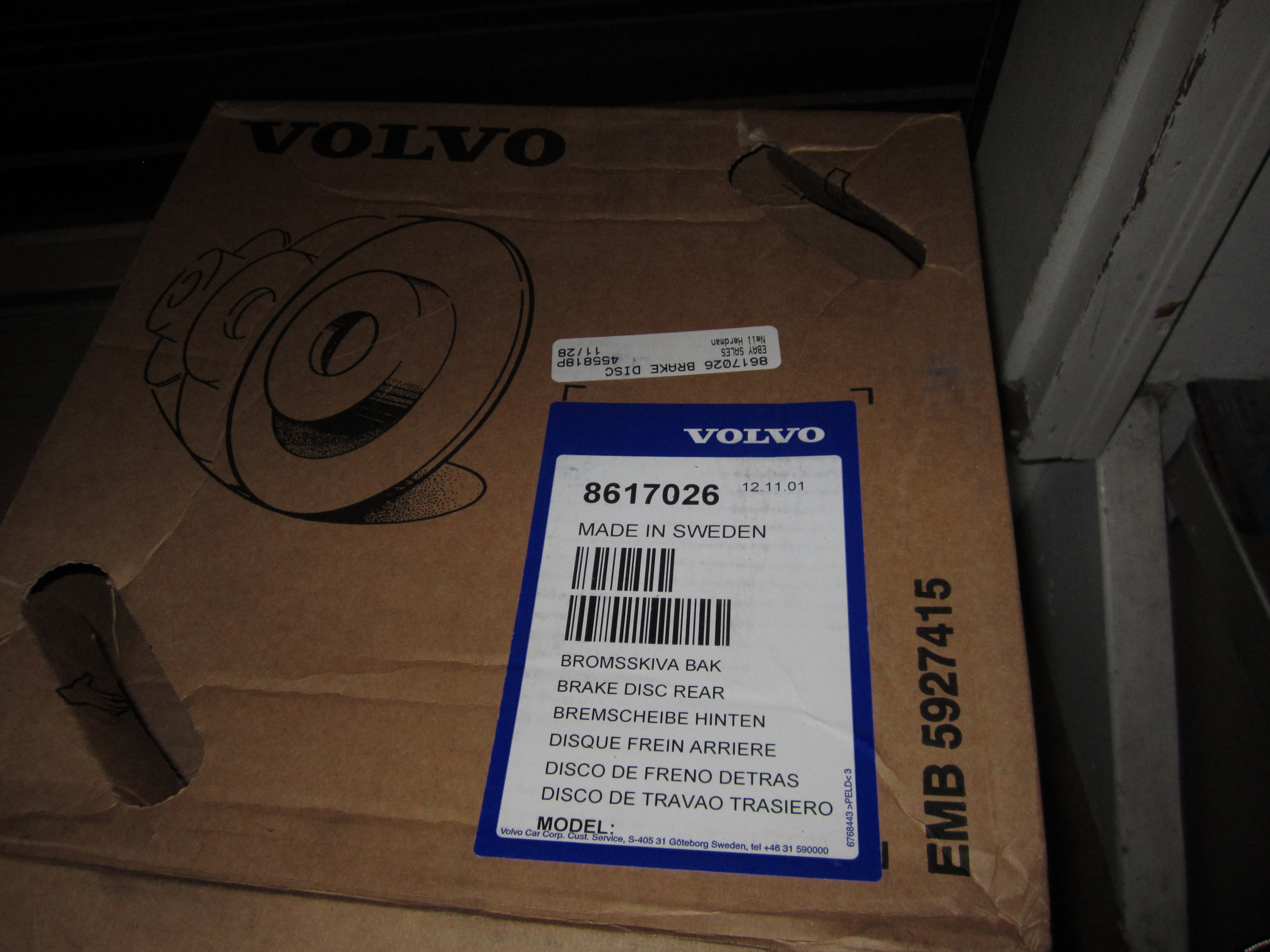

2000 V70R rear caliperThis rear brake uses a vented rear rotor which I have shown before, but here we are again:
2000 V70 R vented rear rotor2000 V70 R rear rotor part #Rear rotor part # 8617026

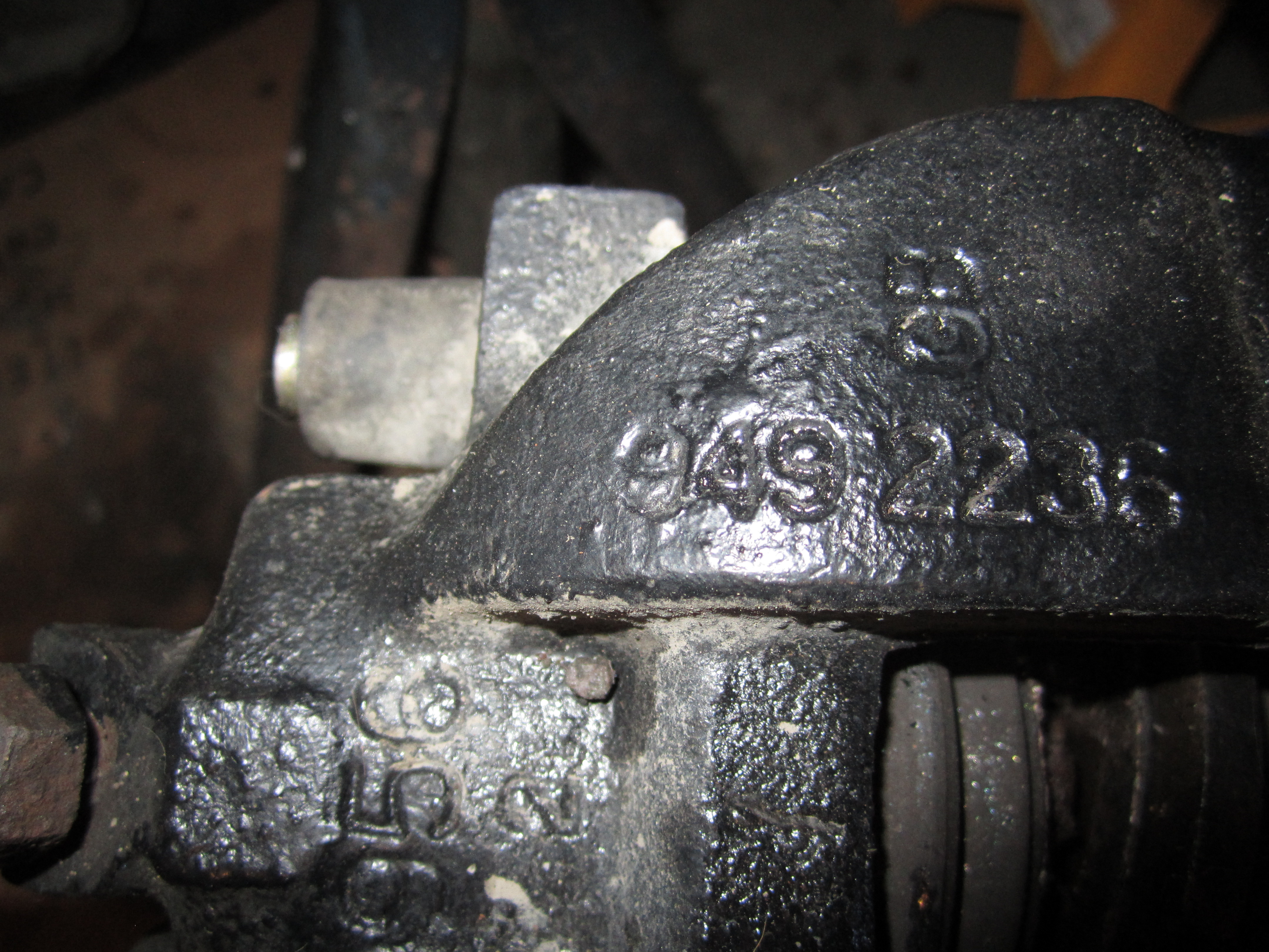

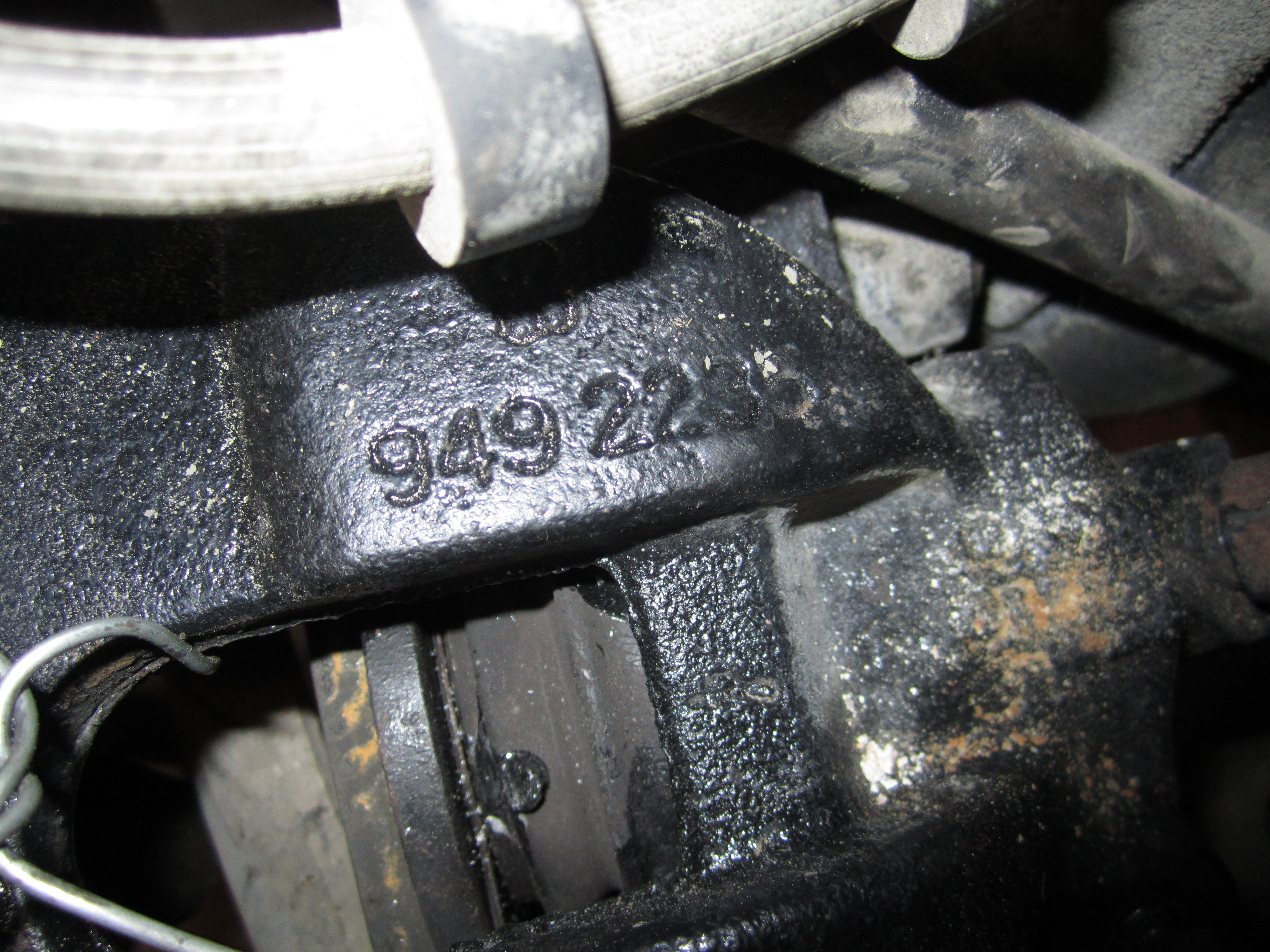

When I look at Vida, it does not even show this part number for the rear calipers as stamped on them:
LH – 9492235 Also numbers 955 2 and 9BS
LH rear caliper part #RH – 9492236 Also numbers 956 2 and 9CG
