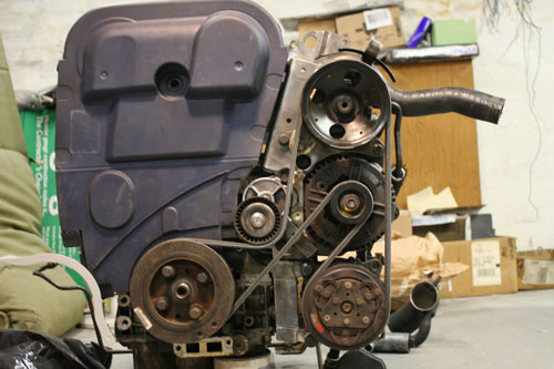

99 v70xc w/AC Serpentine Belt Pattern (Nice Clean Photo)
