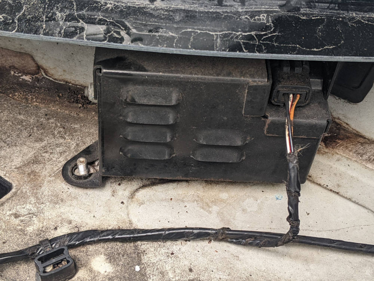

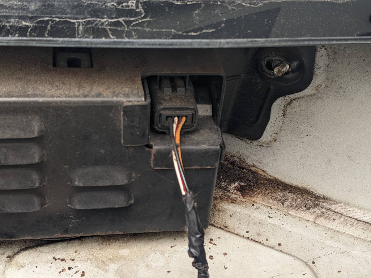

The siren module is here – Take off the nut
And the other nut which is hard to see, up under the ledge in front of the windshield
Now you can take the metal bracket off the car, flip it on its side, loosen the nuts, and remove the plastic box from the metal bracket. Set it back down in the bracket for a moment, as you can now see the connector latch and pry it gently open with a screwdriver to get the cable off the alarm module plastic box.
