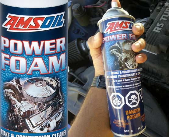

Longtime MVS Forums member Geevs asks about Amsoil’s Power Foam intake & combustion cleaner, and gets many good responses and alternatives. MVS Contributor kcodyjr…
Sucking something in through the manifold causes the engine to stall, and the chemical sits on the pistons and rings. You let it sit, then start it up to burn it off. It wouldn’t be in contact with the valve mating surfaces until it’s itself become an exhaust product.
Cleaning an engine with Seafoam, and the Amsoil sounds similar, is a good idea according to some and useless according to others, and some cite a risk of hydrostatic lock-up. Personally, I’m a believer. But, it’s not going to do much for exhaust valves, unless you do it with the car suspended upside-down.

I’ve been using Amsoil products for almost 20 years now. I don’t like the power foam. Seems like diesel fuel in foam suspension. Doesn’t clean much.
Try the Amsoil PI fuel additive. It works incredibly well. If you are going to pull the head then just let the machine shop handle it. Some chemically clean valves, others high speed wire wheel it, others glass bead it.

Thanks for the replies.
I have tried Seafoam a few times and it was OK. I have not tried Power Foam but from what I have read over at BITOG it works a bit differently – it’s a foaming agent that expands unlike SeaFoam which, despite the word Foam on it, is liquid and susceptible to hydro-lock whereas Power Foam is not liquid. These are the reasons why I was wondering if shooting Power Foam down the spark plug hole may have some benefits – it goes straight into the space between the valves and piston (at TDC) where it can expand and be in contact with the IN/EX valves and pistons. Pouring Seaform down the plug hole will just soak the pistons.
