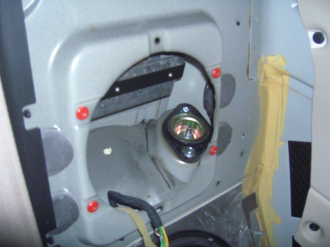

Replacing the rear shocks and shock mounts is more difficult than the front struts. The difficulty comes as a result of working in tight space with little room to turn wrenches. Having the correct Volvo (or aftermarket) tools will make this a very much easier.
First, remove the bottom cushion of the rear seat by tugging upward on the front edge of the bottom cushion. The metal hook/loop attached to the cushion will snap apart from the black plastic clip that is attached to the seat frame.

Just did this on the rear of the 850 wagon with lowering springs from FCP and Bilstein TCs.
Did you have clearance to leave the shock absorber bolted to the rubber mount and pull it up through the hole by undoing just the two 12mm bolts?? By compressing the shock to full compression it would have been much shorter and this may have been possible. This is how I did it on the 850 wagon which meant I could just throw the hole thing out without having to separate it from the mount, however clearance on the C70 coupe looks darn tight.
Then I did all the fiddly holding of the top of the shock with a vice while I tightened the single shock bolt. Then I just dropped the whole thing down through the hole.
One of the shock mounts was broken in half. The car is firm but handles like a dream; at least in the rear. Front is next.”
