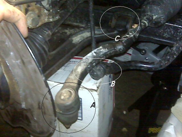

Included below is a photo of the parts I am going to need to replace, Tie rod (I called it a steering arm in last post) I am ordering it allong with the control arms..
I would like to know if there is any pitfalls when installing these… They appear to screw on to the steering rack… is there a trick to know you are getting them on the same exact way the old ones were…?

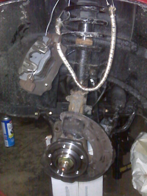

The link Confused_al provided me with was an incredible help with installing the new hubs!!! I followed it nearly to the letter.. The new hubs from Groton’s (FAG) were impressive looking but ought to be for 100 bucks each.. I have read that you need to torque the bushing bolts down once the car is at RIDE HEIGHT ONLY…

photo sorry a bit blurry
A- Tie rod end bushing is cracked around the circumference of the bushing..
B- Sway bar bushing? they appear to be in good shape
C- Bushings I need to replace in order to pass inspection and now am ordering the complete control arm to replace.

mmgibson wrote:
the swaybar is marked B and circled in the photo… Correct?
The sway bar is the thick one (U shape steel rod on the right of your pic), the skinny one connected to the strut is the sway bar link by which the sway bar connected to both sides.

mmgibson wrote:
Also my Haynes Manual shows them using a Balljoint separator to remove the tie rod end (A in photo). Is there a trick for popping this loose if you don’t have a balljoint separator? Or should I pick one of these up before the job?
Yup, that will make your life easier.
