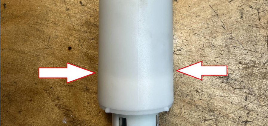

Disassembly of the unit is pretty straight forward. Once you have the pump assembly out of the car, three things need to be done to get the old pump out.
  1. First undo the electrical connector.
  2. Secondly undo the clamps on the fuel tubing.
  3. Lastly you will have to push in 2 tabs on the bottom of the assembly, which will then enable you to slide the pump insert out the bottom. They are in the location of the arrows in this photo:
