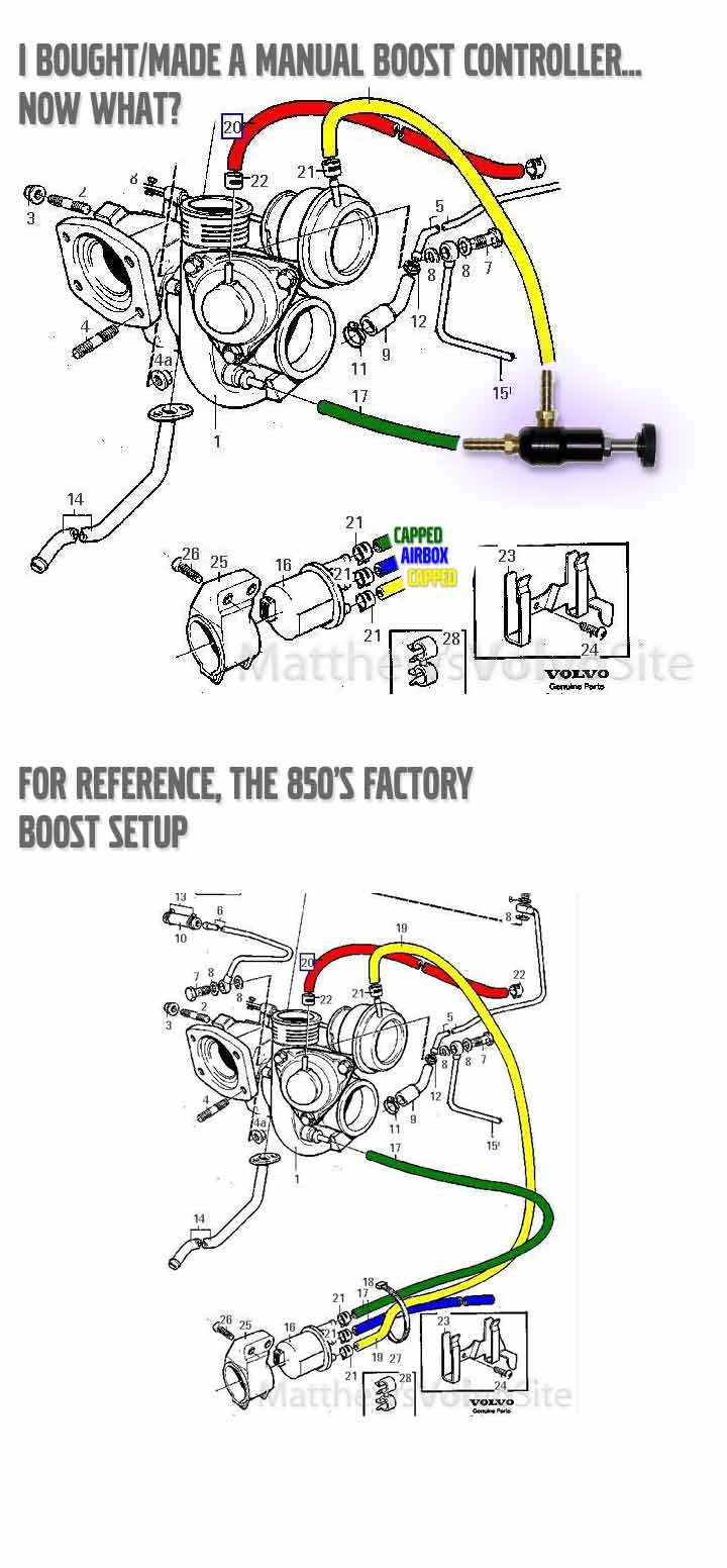

I’ve had a $80 Hallman ES MBC in my 850 T5 for months and it’s great. Yes, you can make one for $20. If I could do it over, I’d go that route. It’s just a dead-simple mechanical device that either works or doesn’t. You’ll know the second you accelerate from your driveway if you’ve gotten it terribly wrong. IF you have a boost gauge.
Installing a manual boost controller - diagram of hoses and routing
Installing a manual boost controller – diagram of hoses and routing
It boosts to 15psi in 2nd, 3rd, 4th gears, and up to 10psi in 1st. Stock T5 behavior is 10psi in any gear. I do not have an ECU remap/chip/tune. I do have an R ECU. I do not get fuel cutoff until ~90mph / full throttle.
