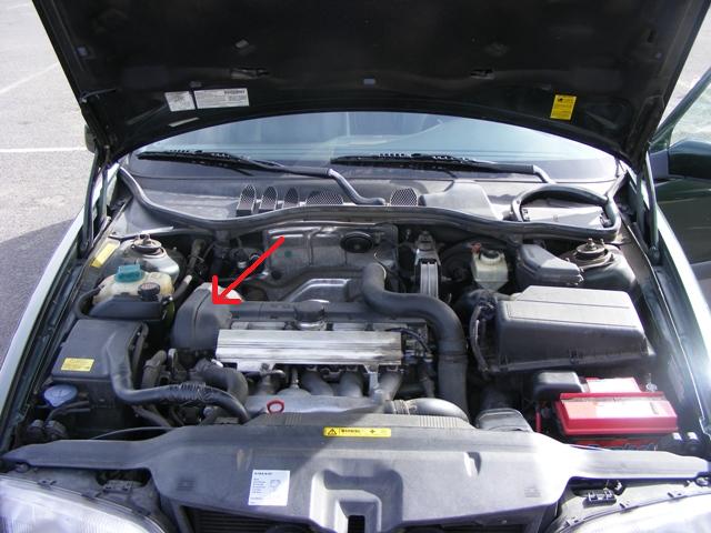

FlyingVolvo » This is my write-up about how to replace the CVVT Solenoid for any of you that get the CEL with code P1332 (“Camshaft Reset Valve”) and have narrowed it down to the solenoid. I did this on my 2000 V70XC and your results may differ, so don’t blame me if you break something.
The CVVT solenoid is located under the timing belt cover. Use a Torx wrench (size 25 or 30) to undo the two screws.

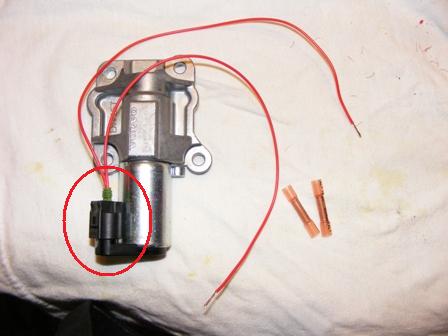

The replacement that I got looks like this and does not just easily connect into the old system (thanks Volvo).

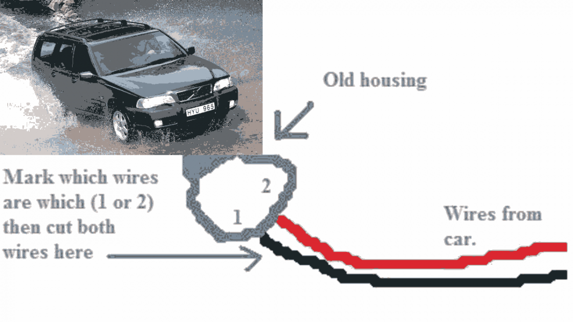

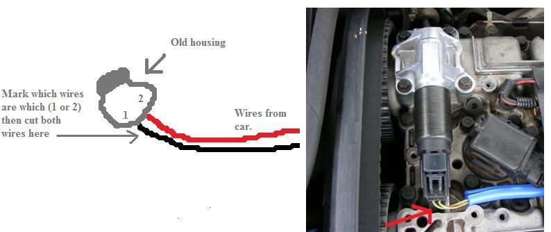

3. Now this is where you need to be careful. You are going to have to cut off the old housing from the power/ecu wires. But before doing so, carefully examine the old housing all around. You will find a “1” and a “2” marked somewhere next to the wires. After you figure out which wire is “1” and which is “2”, MARK it somehow. I wrapped a piece of tape around one wrote the number.
4. So now, (with battery DISCONNECTED + ignition OFF) cut off the old housing where the car’s wires go in. You have a little leeway because the wires that come with the new solenoid are fairly long. Sorry for not taking more pics, but here is my best artist’s representation of what I did! :mrgreen:
carwiresv.jpgYou won’t need the housing that’s been cut off.

6. The new solenoid is a bit tricky. The part (I got from dealer by-the-way; $140 – $20 core charge) comes with a small independant housing, two wires and two crimp connectors. It sort of makes sense how to put it together, but I ran into a problem here.
It doesn’t matter which of the two red wires go into what part of the housing, it just matters which wire from the car they are connected to. After I was all done (I thought) with this project, I got the CEL again. But I had earlier become suspicious of the connection. I realized the connection from the wires to the new housing to the pin in the housing on the solenoid was bad. So I removed the “middle-man” housing, and simply connected the red wires directly onto the pins in the solenoid and filled it in with silicon. I’m talking about this here:
But note this, on the new housing are two marks both “1” and “2”, just like the old one. So regardless if you decide to not use the new housing, still set it up as if you were, and then mark one of the wires as “1” or “2”. You don’t want to mess this up!

9. Now all that needs to be done is make the connection. Take wire #1 that you marked earlier from the car and use the crimp connector to connect it to wire #1 from the new solenoid. Do the same for the #2 wires. Wrap the connections in heat resistant electrical tape (I also wrapped mine with some leftover silicon tubing from my vacuum lines).
