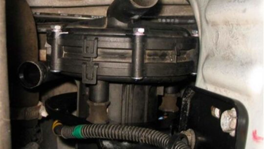

My airpump has started to sound like a vacuum grinding up a cat. Of course, the noise only lasts a minute or so, then it stops and all is well. I guess I have 2 questions:
1. What does the air pump do?
I ask this because the car runs no different before the thing kicks in and no different after it shuts off.
2. If nothing changes regardless of this thing being on or off, do I actually need it? Can is be simply unplugged and ignored?
Some people may gasp and sputter at that last statement, this is an honest question looking for a direct answer…

IVIUSTANG » Yes, this does get rid of the P0410 code completely. erikv11 » The ECU doesn’t check the pump directly, it checks the relay and the solenoid…
Volvo 850, XC70, C70, S70 & 1998-2000 V70 Overview If the air pump has failed in your Volvo, there is an alternative to buying an expensive new or…
The whole job took about an hour, skinned one knuckle, didn’t break anything new and I only used about half the cuss words I know…
If the air pump has failed in your Volvo 850, there is an alternative to buying an expensive new or used Volvo air pump: you can buy a rebuilt or used VW air pump and convert it for use in your Volvo…
