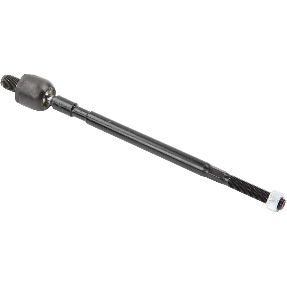

  7. Inner tie rods are connected to steering rack by a 33mm narrow bolt that’s part of the round end of the tie rod. You’ll need the inner tie rod remover from Autozone tool (#25296). This is the only inner tie rod tool that will work in removing the old Volvo rods. There’s no room for any kind of pipe wrench, vice grips or anything else. The tie rod tools with the long pipe and end fittings will NOT work here. I tried every single one on the market. There’s just not enough bolt to latch on to. On other models, there’s enough room to get a pipe wrench in, but not on the v40/s40 models.
  8. Open the tool and put it around the inner tie rod. There’s a large protruding washer that helps hold the inner tie rod to the steering rack. Make sure your tool is bumping up against this washer but not around it. When tightening the bolts on the tool, leave yourself and inch or two to be able to turn the tool with the ratchet. Once you tighten the tool around the rod, use your 3/8″ ratchet extension to turn the tool. Remove inner tie rod.
  9. Clean the area thoroughly. Make sure your parts match. They are not going to be exact, but length and thickness are important here. Notice the new tie rod end has more room for the pipe style tie rod tools to latch onto. You could use the pipe style tools to install since its a little quicker. I used the same tool in installing.
  10. Remove nut and Install the new inner tie rod end with steering rack washer. Put some thread locker on the end if you wish.
