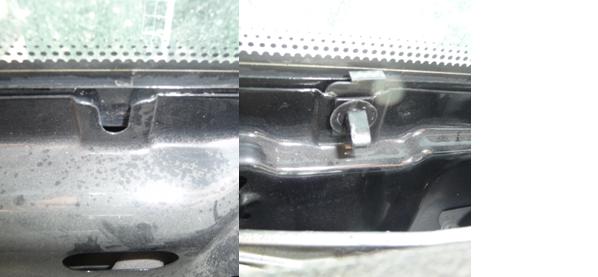

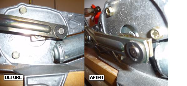

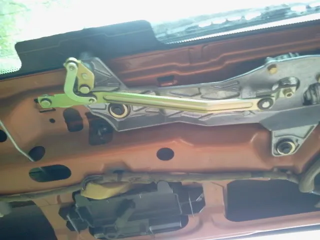

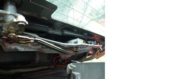

“I finally got tired of looking at the rear wiper arm parked at the 1:30 position of my V70. It wasn’t just a matter of repositioning the wiper arm because this would just cause it to wipe the tailgate. The entire window would get wiped – it would go from 1:30 to 3:00 back to 9:00 then home to 1:30. I searched around this site and found at least one other person  with this problem but no solution, so here’s my first how-to.”
