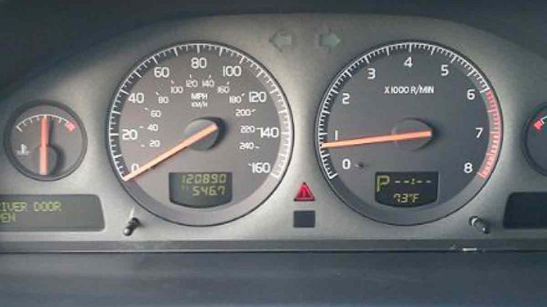

What brings me here this evening is the 2001 V70 XC. I always deal with a small Volvo (only) garage for all work – but they sent me to a local dealer to get ECM/TCM programming software updates, because they don’t have that equipment in-house. The car had occasional transmission hiccups, and they’d seen bulletins about updates that could address that.
Anyway – when the dealer hooked up the car to their equipment to check the code versions, etc, and ran a diagnostic, it came back with all sorts of “DTC is found active/not active” status errors on about (14) different things. The service guy pointed them out to me. What he was showing me was that he was seeing no transmission codes, but many other unrelated ones. These included the door control module (driver), many other door-related signal alerts, sunroof error, etc.
He asked me if I’d had problems with any of these things and I answered (truthfully) no. Up to the point I parked at the dealer, all door switches, etc, were working fine. I told him that, despite what the codes might be showing, none of the problems were manifesting, so I had no interest in replacing anything based on codes.
Problem is, after they updated ECM/TCM software and buttoned it back up, NOW many of these codes are manifesting. The driver’s door controls are all completely inoperative. The bush-button lights up top don’t work. The sunroof controls are dead.
