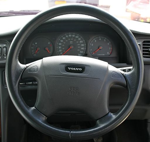

Steering wheel of a 1998 Volvo V70 taken in 2004.
