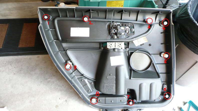

  4. Pry around the door trim using upholstery tool wrapped with cloth.
    * There are 9 plastic clips.
