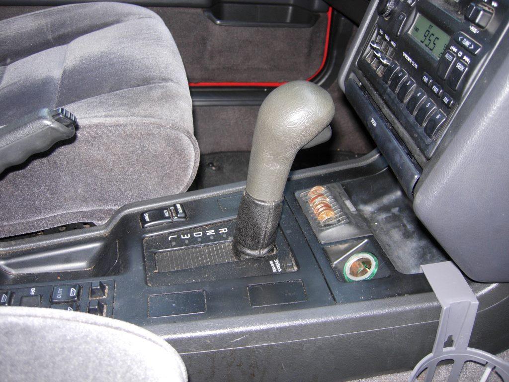

Can anyone tell me if the dash, steering column, airbags and automatic gear shifter from a 1996 850 will interchange with a 1993? My 93 needs these replaced and I have found a guy that is parting out his 96 but before I buy them I want to be sure they will work.
Ozark Lee » I looked up part numbers in VADIS and the steering wheel changed at the end of the ’93 model year, the air bags changed at the end of the ’95 model year, the steering column changed at the end of the ’94 model year and there are some badging differences.
I’m not sure how substantial the changes are and they may well work fine but the part numbers are indeed different. If you are getting the stuff cheap enough it might be worth a try.
