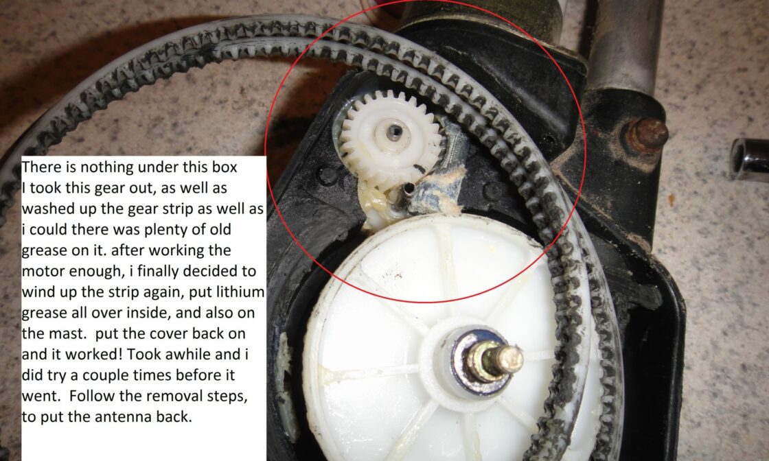

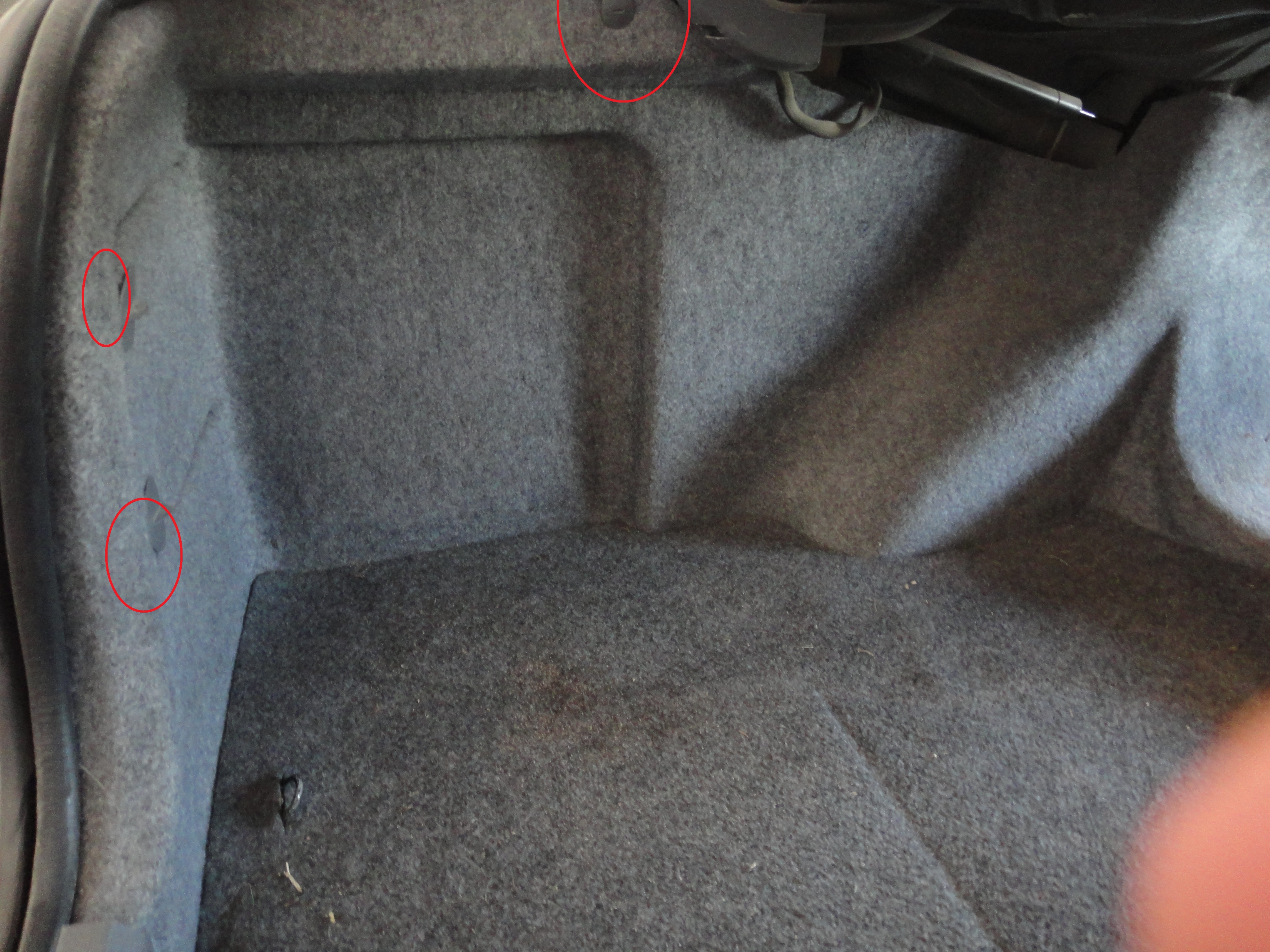

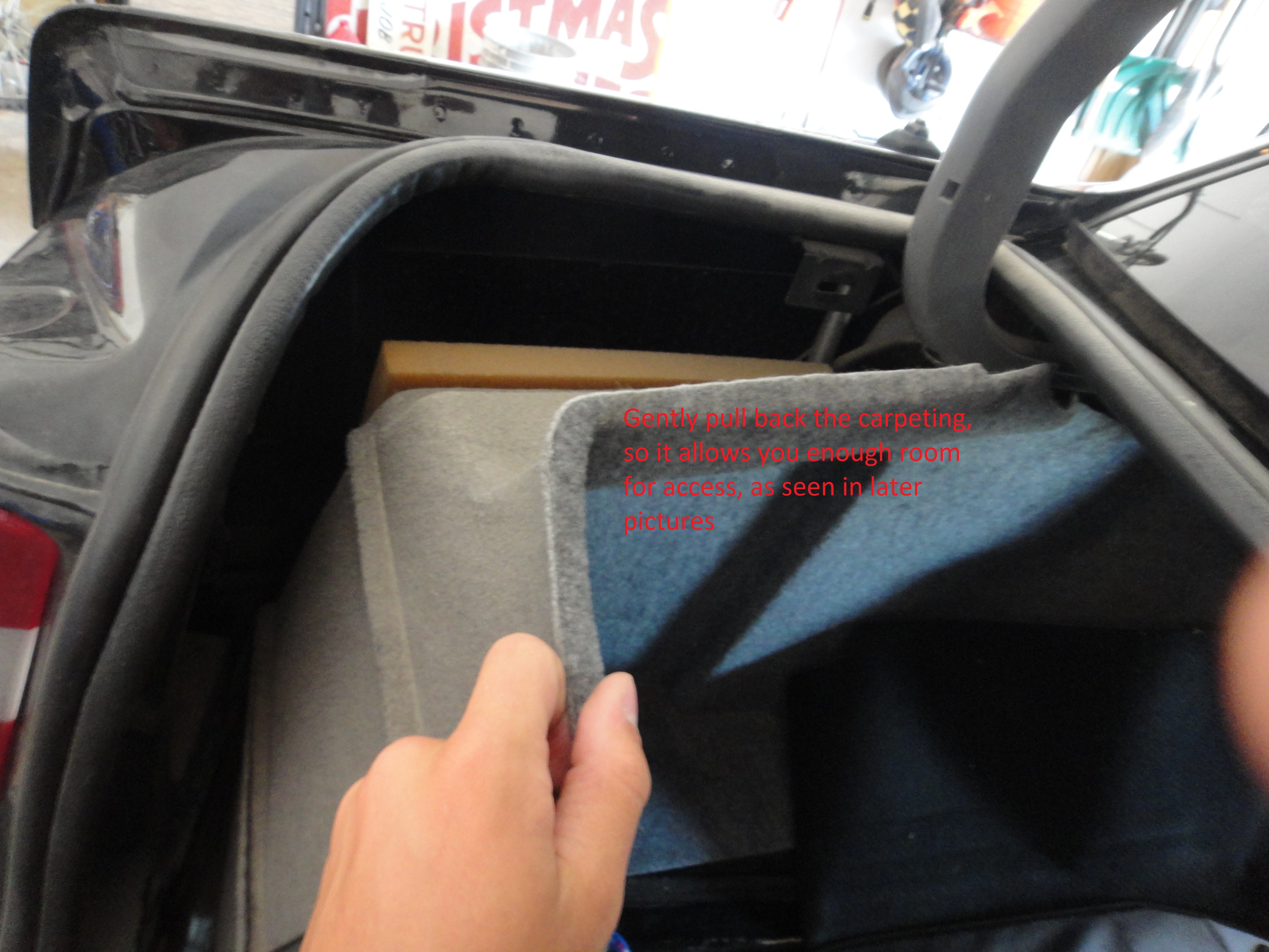

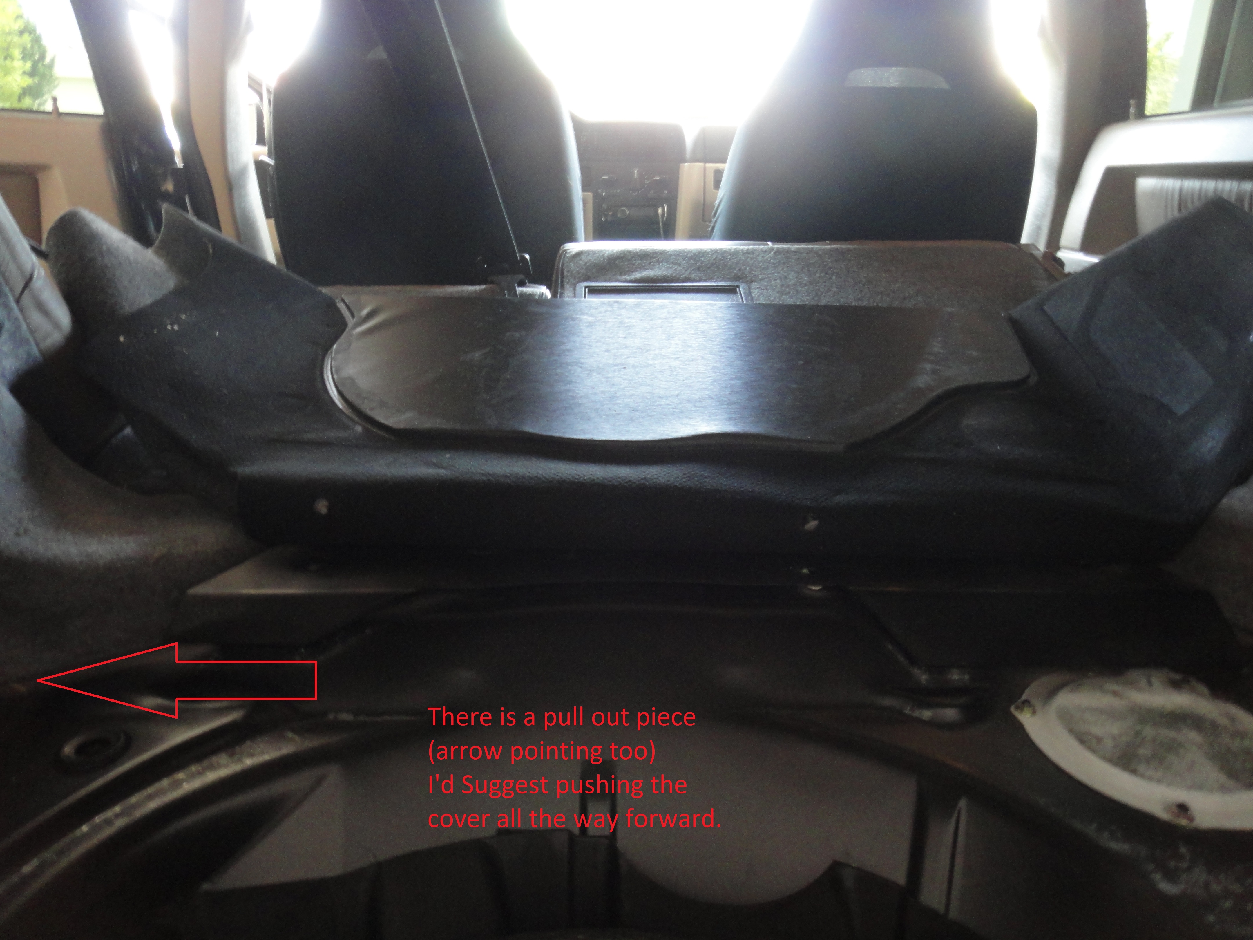

Fish stick88 » Since last winter I’ve been going without a power antenna, which often gave me little or no reception. I finally decided to tackle it I’ve created a photo collage as best as I could, I check back often so if you have any questions feel free to ask. I couldn’t hear the motor even trying to run, but i figured i would give it a shot.
Step-by-Step how to Replace Antenna
One of a dozen or so photos of the antenna fix procedure. Follow the link below to see the entire DIY. Extend the antenna mast all the way and then wind the gear with the strip on it by hand.

tourspin69 »Just performed this after watching Roberts video. The only issue that I had was getting the new strip/belt to catch and feed in. It was very tough to do. In fact until I had my 14 year old son help, I was getting pretty frustrated. I had to feed it into the gears a bit and then put the cover on…then mount it. While holding it, my son powered the radio on and I had him immediately turn it off so it would pull the strip. After doing this (hitting the power button while I was trying to feed it) 4-5 times it finally grabbed and fed in. Done deal. Works great now.
Take out the plastic stops, turn them 1/4 turn either way. There are 3.
