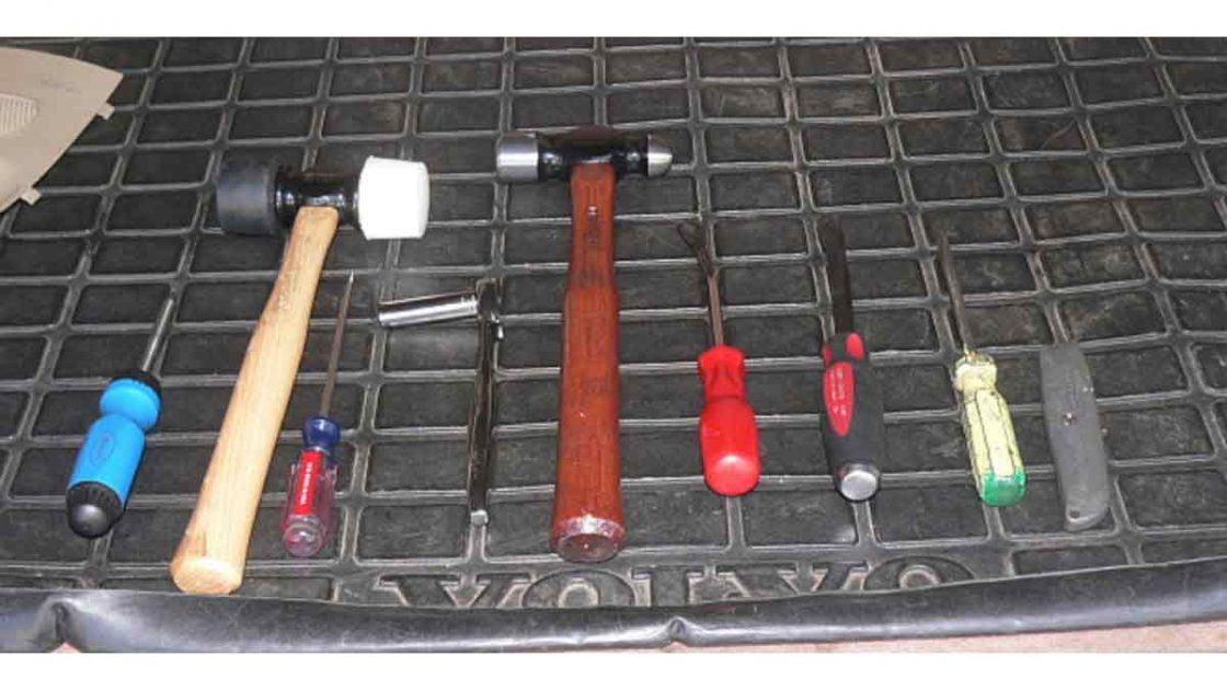

The only tools you need are:
  • a large flat blade screwdriver
  • a small flat blade screwdriver,
  • a T-25 Torx
If you don’t have Torx bits, here is the best deal I know of for all the Torx bits you need: Lisle 12 pc. set from Sears
