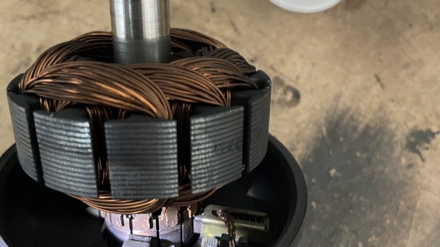

DonnVa » I started getting a BCM-0070 this weekend after the car got hot, but only upon starting again after parking for a few minutes. No other errors. I pulled an ABS pump from a 06 S60 on the way home today and swapped it out with the goal of taking mine apart to take a peek in it and see about replacing the brushes. Well when I pulled mine off it came apart with the little bearing too. I used the YouTube video by XeMODeX to angle the little bearing back into place after cleaning and greasing it. Here are some pictures of the inside of the pump in case they haven’t been posted before..
Bcm 0070 Abs Pump Fix -
Bcm 0070 Abs Pump Bearing -
