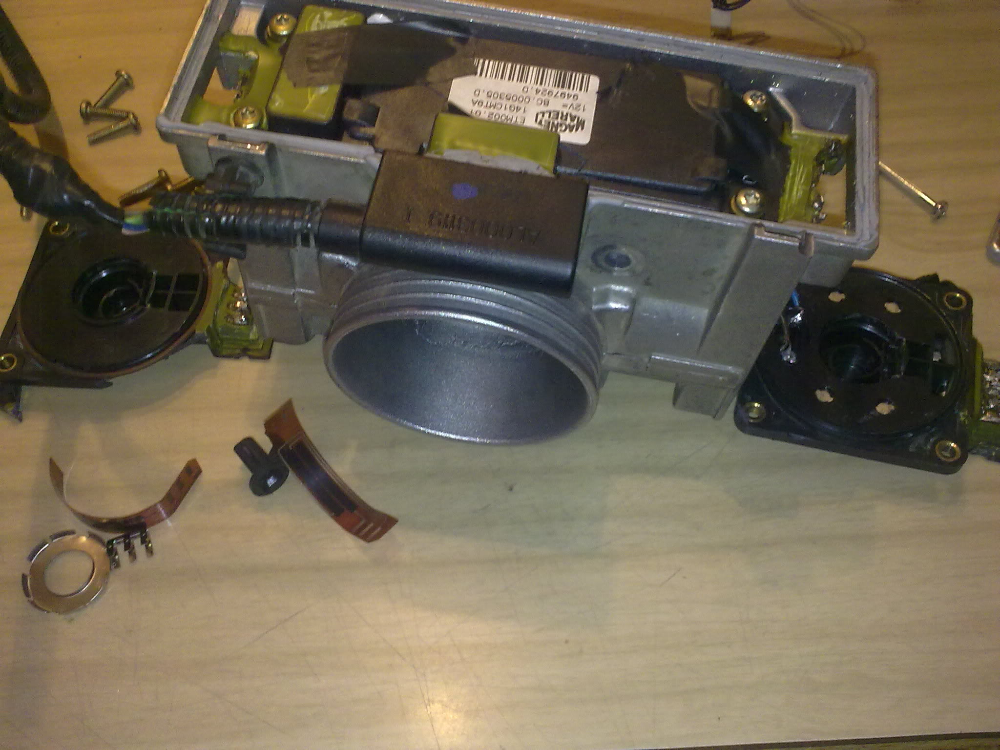

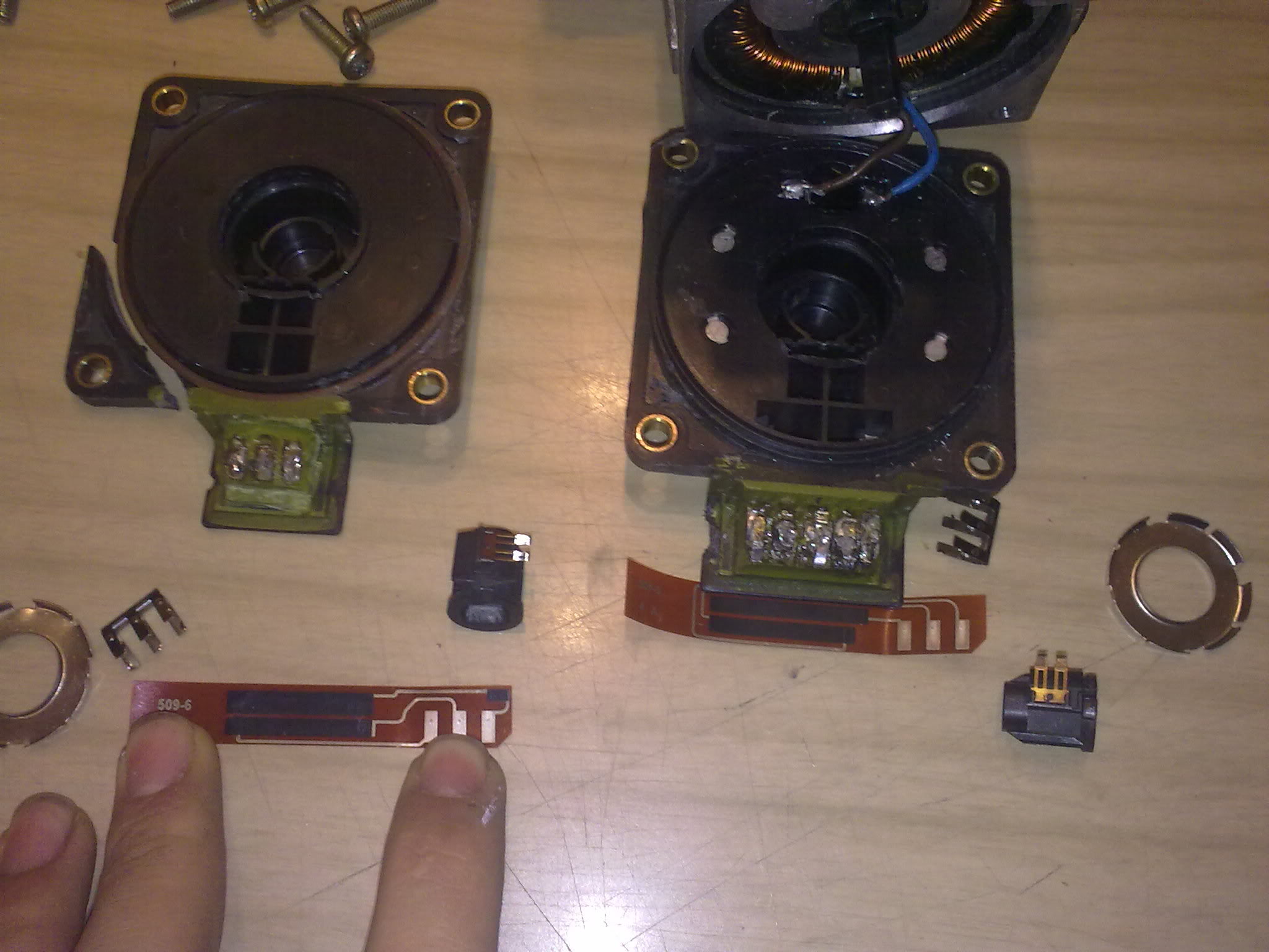

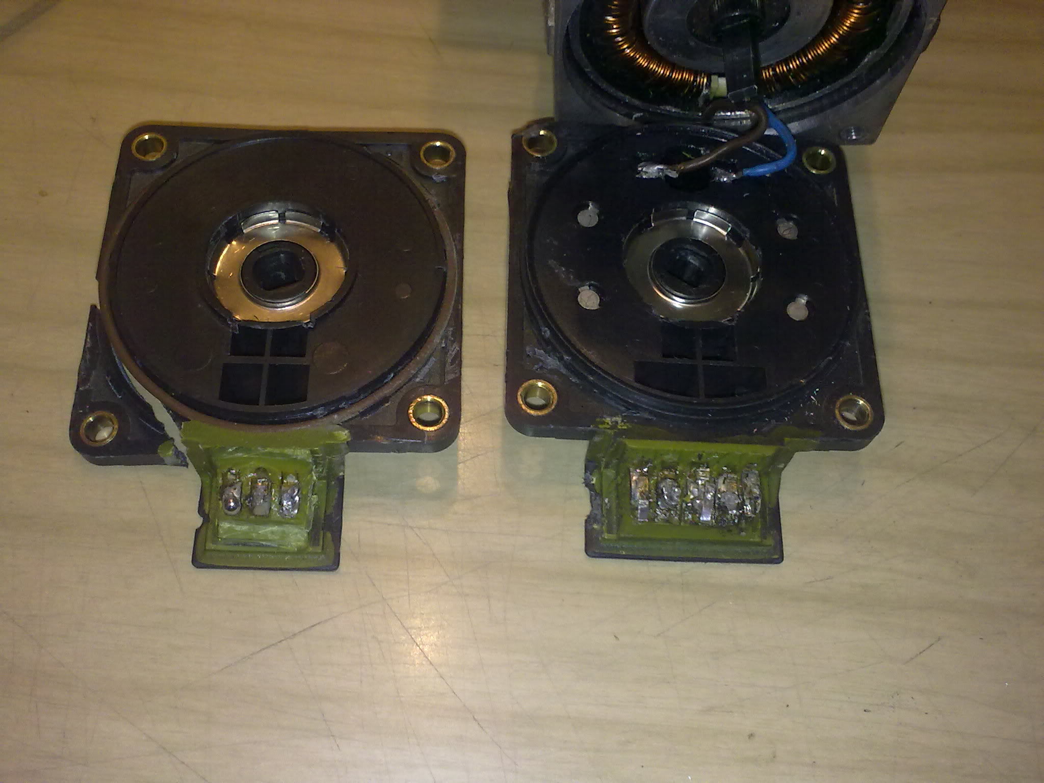

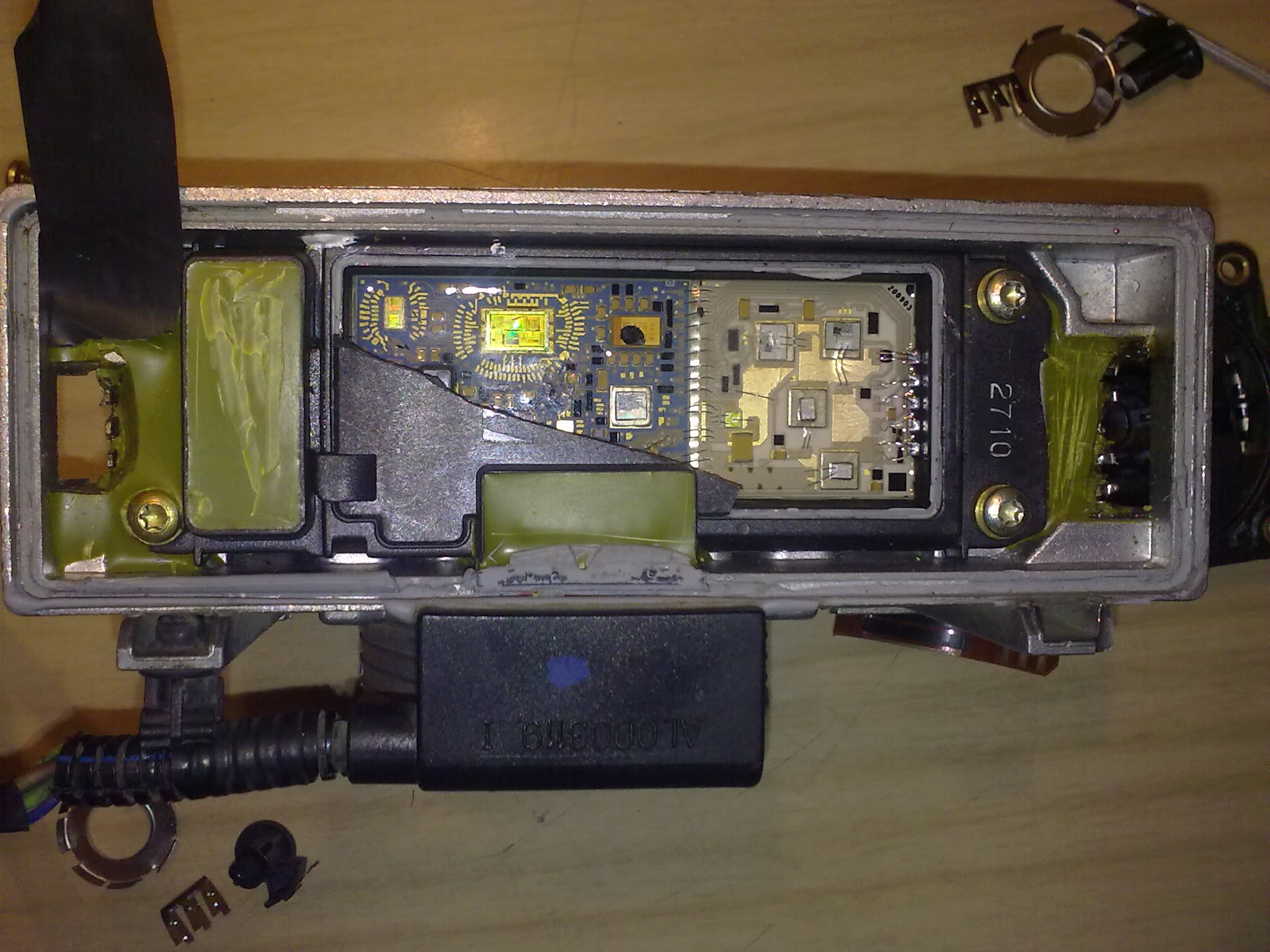

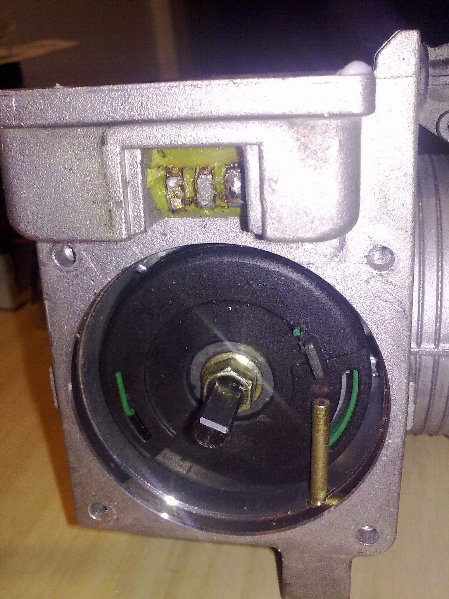

Actually I bought the used ETM on ebay, when i exchanged the tps with the contactless tps, i saw that this ETM has wear resistor also (look at the picture), how much time would you gave it till the ETM had fail? but, now with the contactless tps it should be good for very long time, or forever i think.
