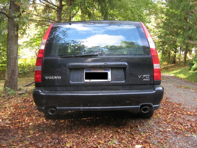

For those with V70 AWD versions with the stock single outlet muffler on the right side, the 2000 V70 R dual muffler is a direct fit. I had one installed today on my 98 AWD. There are lots of earlier posts on this but I hadn’t seen one recently. I’m attaching photos of the muffler system and how it looks on the car. My understanding is that there is no performance advantage, but it looks and sounds good. The muffler system was $272 at Waltrip and the endpipes were $42 each.

It should also be mentioned that the factory ’00R dual exhaust also fits all AWD 98-00 applications including the XC
holler1, the part number for that left frame is 9484490 according to the swedespeed article.
