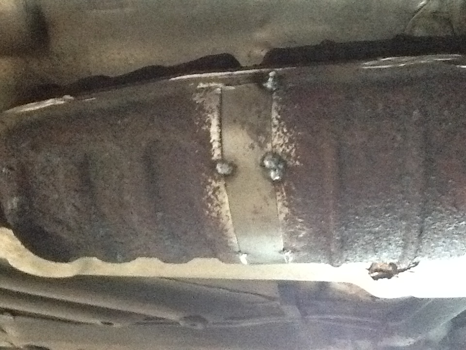

MVS Contributor Kahl has an exhaust leak at the catalytic convertor on his 2000 Volvo XC70. Then he fixed it by being a man and DIY welding it, instead of taking the easy but expensive route of buying a new cat.

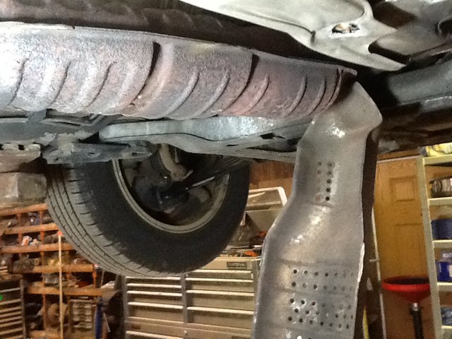

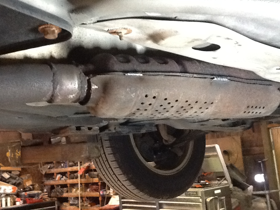

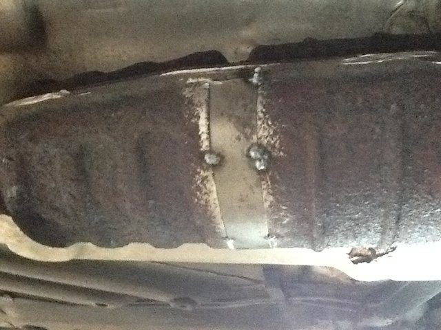

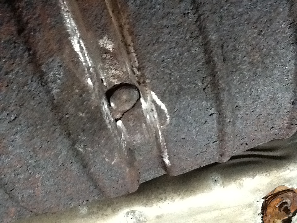

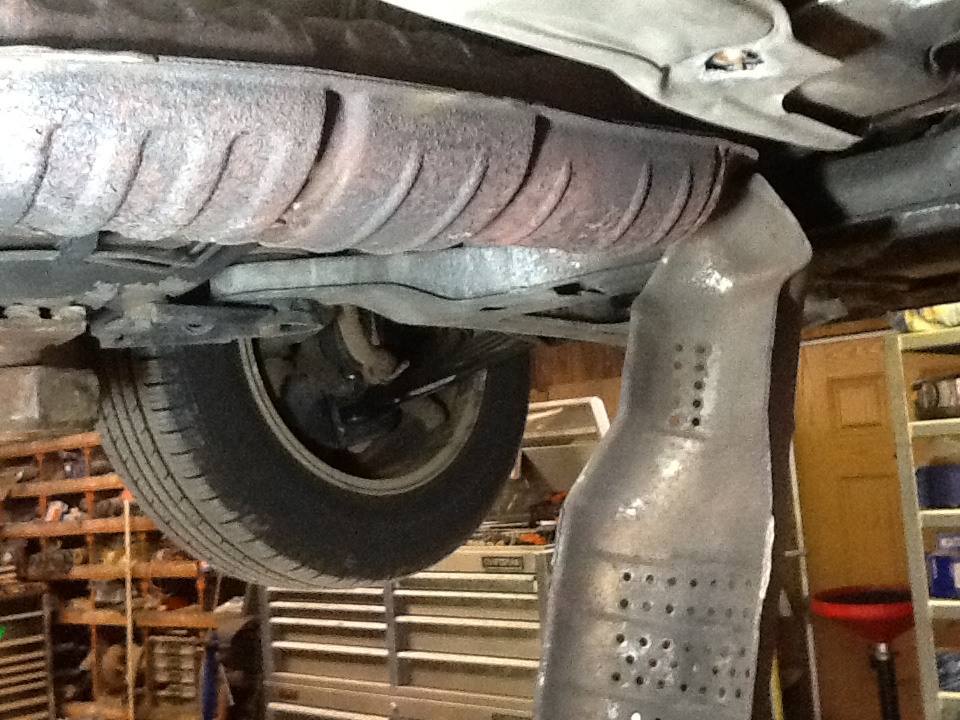

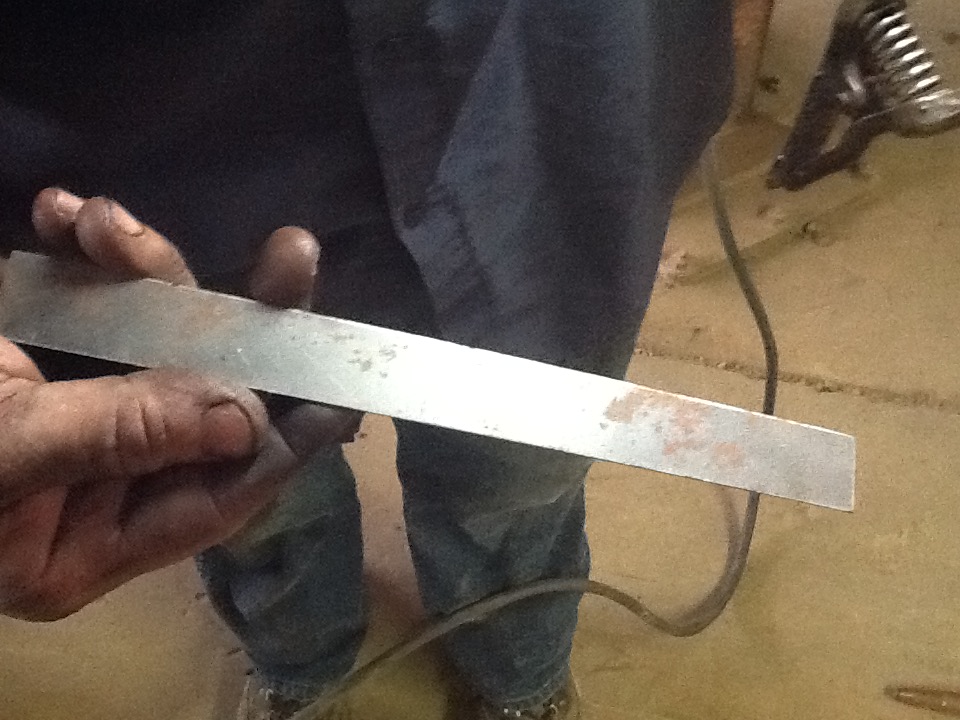

While under the car with it running I heard the ringing of a exhaust leak coming from the cat. I cut the protective shield shield so I could pull it out of the way. There was a crack/hole in the center where the rivet is seated. Ground off rust and welded in a sheet of stock to seal off the leak. Beats buying a new cat. It is so nice to have a neighbor with a lift and welder.
MVS member 57gretsch too had an exhaust leak, and just saved himself huge money over buying a new cat:
Just did the same thing on Monday. Also welded up the joint closest to the manifold. I was told that I needed a new cat when I took the car in for a safety. After pricing them out I decided to have a look myself. Won’t be going back to that station anytime soon for opinions or work.

Exhaust leak fixed
Tacked sheet first then filled in
Stock sheet metal
Heat shield cut free
Crack at rivet
2000 V70 XC crack in cat
