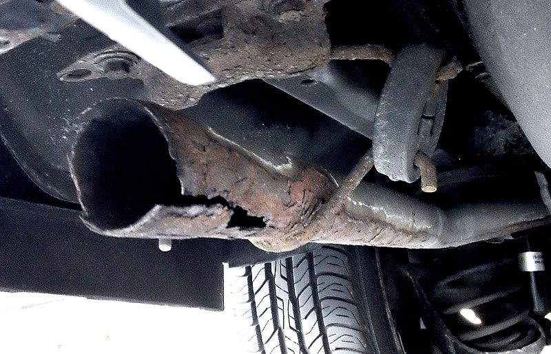

The two ends of exhaust muffler are deteriorating. The tail was repaired by inserting a foot long pipe and putting clamp to keep it in place.

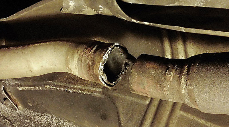

Below is a photo of where muffler meets the CAT. There are two clamps over 3-4in adapter connecting the two. The adapter is visibly rusted and it has 1″ of open hole, hence I ask:
1) Was the muffler short, so to make up the adapter help it reach the CAT?
2) Is the CAT short, trimmed off for…?
3) If replacing muffler what make and size would work best?
4) Step for undoing the two clamps and then removing the adapter?

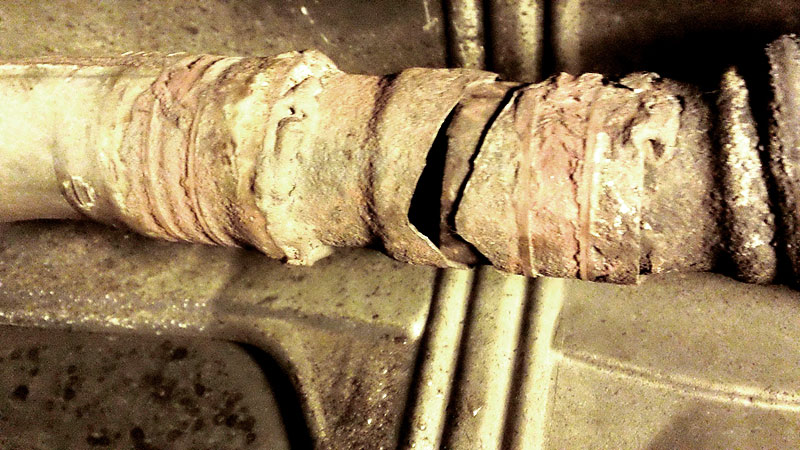

Nonetheless, the coupler inside the exhaust is stubborn. I have separated the exhaust lip from the coupler layer to see if there is a weld getting in the way from sliding out.
Few photos of progress. I will files the exhaust lip before installing new coupler. Any pointer for removing the coupler?

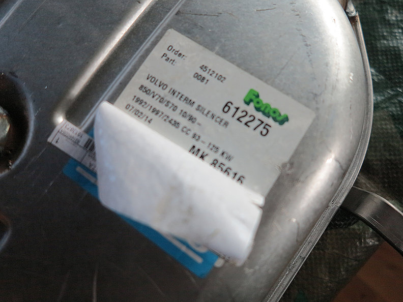

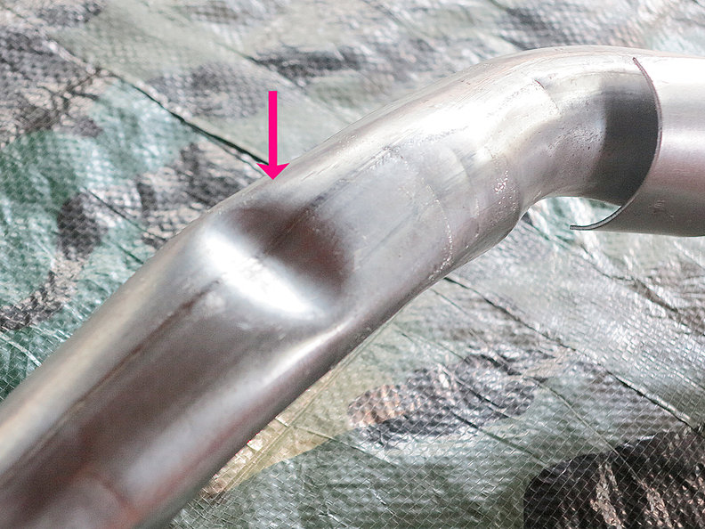

STARLA arrived today.
Looks beat up. Are these dings a problem?
Then things got REALLY weird:
The customer services is mute. A quick research… Peeled the Starla sticker and discovered Fonos, notice MK 85616…
