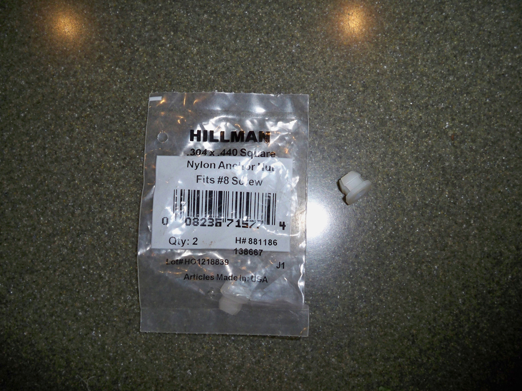

- 4 square nylon anchor nuts. I used Hillman .304 x .440. (image1)

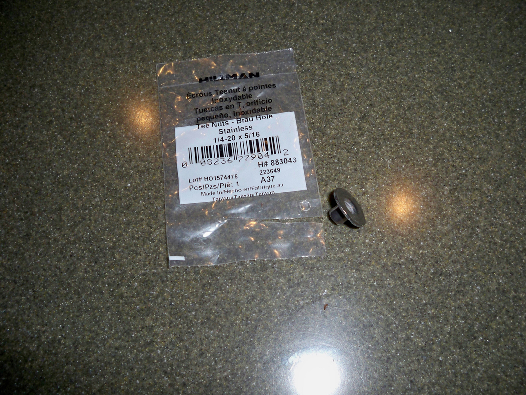

- 3 stainless tee-nuts. 1/4-20 x 5/16 is perfect. (image2)

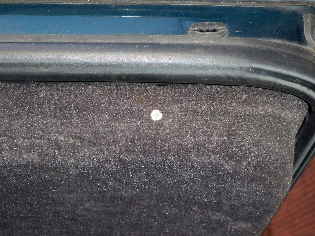

Remove the tailgate trim. There are 4 elongated ovalish holes in the bottom of the tailgate, where the plastic clips should go into. The square nylon nuts fits perfectly in there. There are 4 pockets on the right under the rear window, again where the plastic clips should go into. The tee-nuts fits right in there, you might even have to force it a bit. You can’t put the tee-nut in the middle driver’s side, as the threaded rod will interfere with the wiper arm.

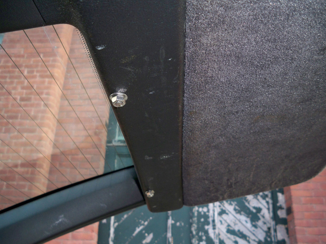

Do not put the threaded rods into the tee-nuts just yet. On the trim, drill holes from the INSIDE on both top and bottom, right in the middle of the clip mounting point. The top holes should clear 1/4 threaded rod, and small hole in the bottom, I did mine with 3/32, which is plenty big for #8 screws. Put 4 #8 screws part way into the trim so it sticks out just enough to locate the nylon nuts.
Once they are lined up, you can screw them in, the nylon nuts spreads slightly and holds the trim in place tightly. Now, on the top side, you feed the threaded rods through the hole, and screw them into the tee-nuts. Put the washers, and the lock nuts and tighten it. I’d be careful not to over tighten it.
