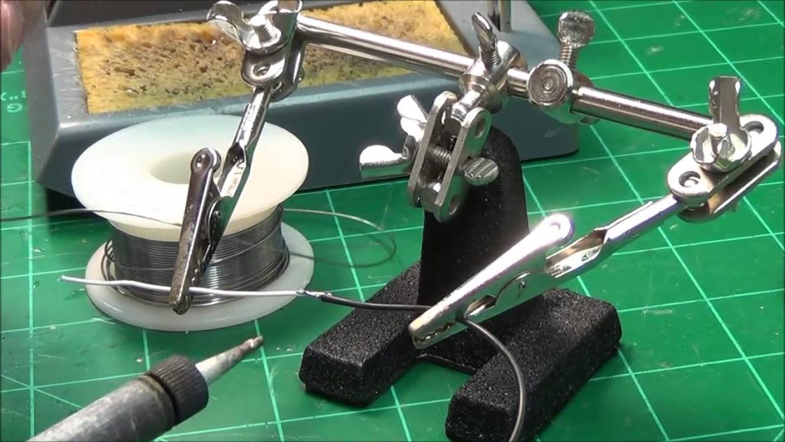

Be sure you have a tightly and neatly twisted joint with no frayed ends. A good solder joint depends on starting with a solid mechanical connection.

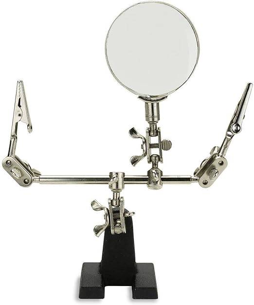

If you have a set of alligator clip “third hands”, break’em out and secure your work to hold it still.
If not – Don’t forget the MVS Amazon link: https://amzn.to/3GKkXeo

Then clean the hot iron tip on a damp sponge or paper towel, wet it with a very small amount of solder, then apply that small ball of hot solder to your work for initial heat transfer, carefully feeding just enough additional solder to “round off” the joint. The closer you can keep your joint’s overall diameter to the insulation’s OD, the better.
To avoid melting the insulation, don’t leave the heat on your joint any longer than you need to for a clean joint. Get the shrink placed quickly.
