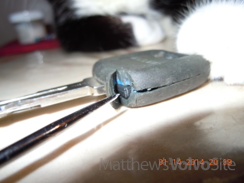

After that just cut away on any key you can find and it should work even though I’ve been told that a unprogrammed chip will interfere with this mod so you have to remove the unprogrammed chip from the key. Here are pictures on how to do this. I have 2 keys as I mentioned before. One with a programmed chip and the other without or malfunctioned chip which the dealer couldn’t program. I removed both chips. 1st the defective chip key on which I cut a little too close to the chip and took off a corner but fortunately that DIDN’T matter and I did it correctly on the programmed key.
I think earlier Volvo’s have a glass capsule with the chip in it but mine had these squarish chips in it. They come out easily. Just make sure you cut into the side where the blue dot isn’t located. After cutting down the side of key towards the key blade you cut sideways widening the area to loosen the plastic around the chip and chip will just slide out by itself. This chip is more robust than the glass capsule version so a few hard cuts won’t damage it. Please study pictures carefully especially the cut going down. If you feel resistance DON”T force it. Reposition and try again.
