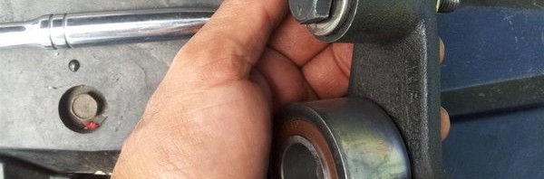

First thing to do is remove the T45 bolt from the timing belt tensioner pulley as you can’t use it on your motor. Use a vice grip to hold the rear washer and turn the T45 until it screws off the washer.
Then remove the pulley sleeve as this needs to be drilled out to 10.2mm diameter.
Grip the pulley sleeve with a used cut timing belt to avoid damaging it and place it with the large end on your drill press base.
Make one pass while using cutting oil to prevent damage to the drill bit (get someone to spray the oil while lowering the drill)
You should end up with a very neat hole of approximately 10.25-10.40mm. (mine was 10.33mm) This gives the bolt the required 0.4-0.6mm of play from the M10 bolt sides. Drill the rear washer out as well. Remove any burrs with a file. Thoroughly clean the sleeve as its inner & outer surfaces must be totally clean.
Now insert the M10 bolt through the newly drilled sleeve through the timing belt tensioner pulley and place the newly drilled washer behind it. You will now need to mark & drill your timing cover as the new bolt will prevent it from fitting. I used a 30mm hole saw and it looks neat and tidy.
