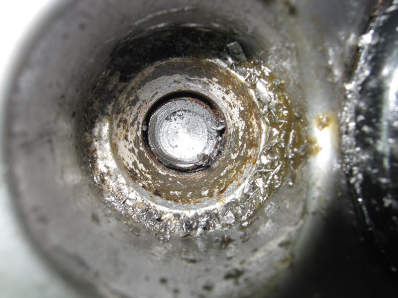

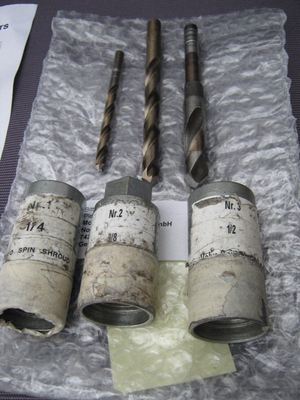

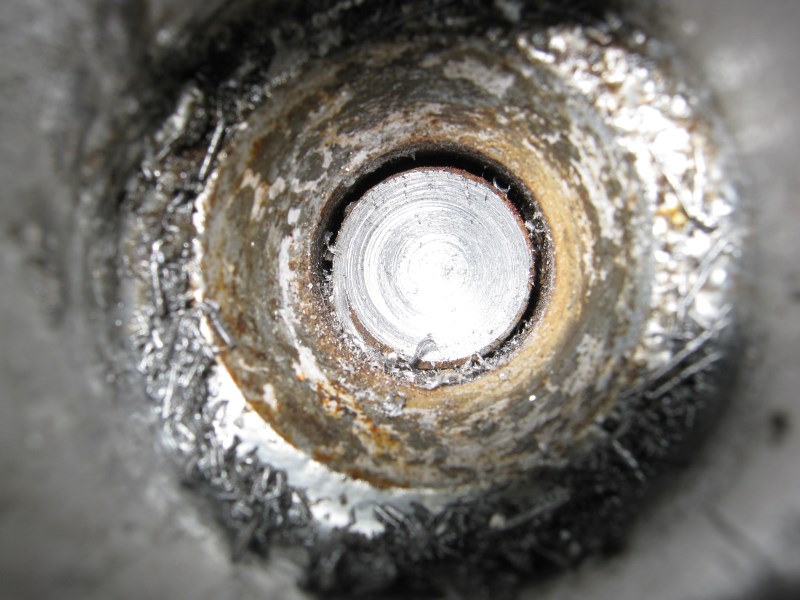

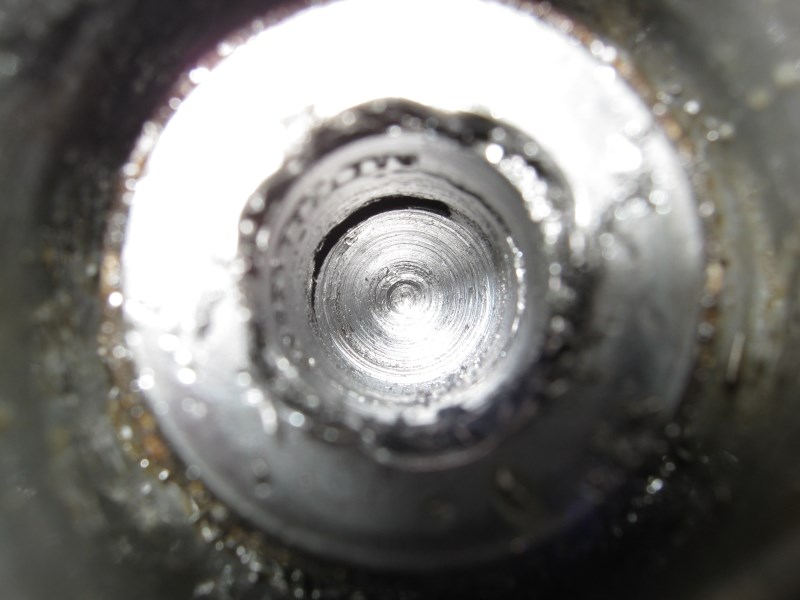

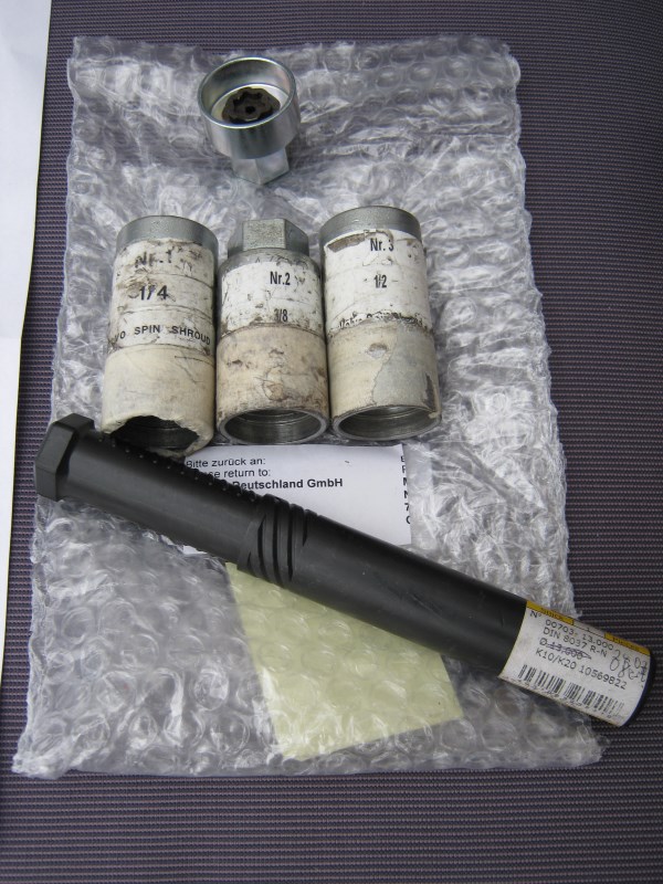

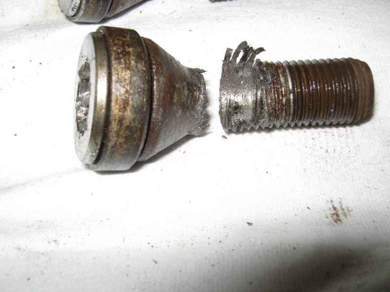

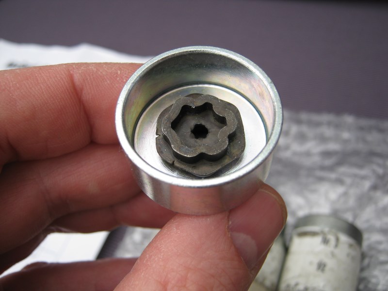

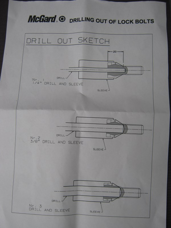

Project: McGard Locking Wheel Bolts Removal – Drilling Method DIY
Lost your wheel key? Feeling down? Well cheer up guy and grab a drill, because MVS has a DIY for you on how to defeat the Volvo wheel locks.
McGard Locking Wheel Bolts Removal Tutorial
See detailed images below.
Koen says:
“…Of course I first tried to unbolt the locking bolts using the new key, but that was also unsuccessful…
Drilling the bolts out is not a difficult task, but it is an extremely heavy and time consuming job for someone without a lot of experience in this field. I would recommend the following things before you try this yourself:
  • Car lift to get car up to a good working height. (I did this without one but wouldn’t do this again if I had to remove another 4 bolts.)
  • Professional drill with low rpm and high torque characteristics. (Like the Metabo I used.)
  • Drill lubricant
  • Safety glasses
  • Patience, lot’s of patience”
