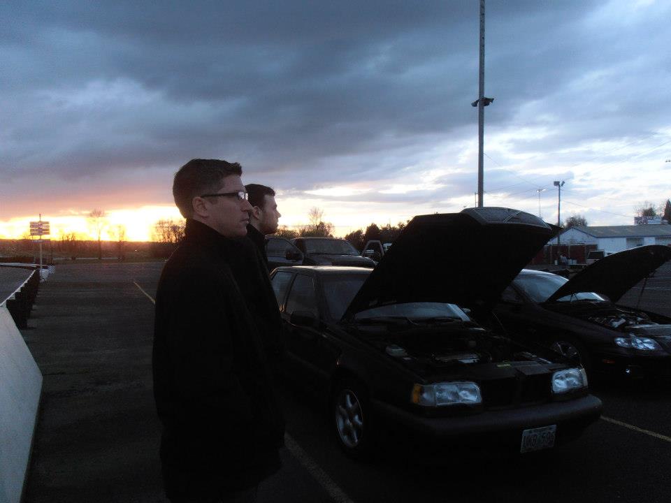

To Begin… Weather: When we arrived at the track weather was not looking good and we got caught in a few sprinkles that seemed to threaten the evenings events for sure.
However after a 30 minute wait, the weather cleared, we got the go ahead from the tower, and we lined up on the grid! The first run put down a surprising 17.16 second run with a 2.55 60 foot time. Not too bad for a bone stock 225K mileage automatic transmission 850. Thanks to Kyles consistent launching the second attempt (also bone stock) ran a 17.14 with a 2.67 60 foot time. If nothing else this little machine is consistent and these were the kind of numbers we were hoping to see in stock form so far so good!
