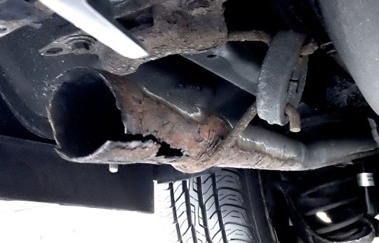

MattinEugene » I have a 73 145 (B20F). When I got it the exhaust was pretty well shot, so I had a muffler shop put on a new exhaust. It sounds like a farm tractor. I believe originally they had two mufflers (and a resonator?). I’ve had a different muffler put on, and it still sounds terrible. Is there any way to get this to be a normal, quiet car, short of buying the complete exhaust system from somewhere like VP Classics? Love the car but it’s an embarrassment to drive like this.
