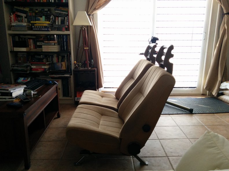

This is my gearhead IKEA project. I think I started on this because my couch was stupid and uncomfortable.

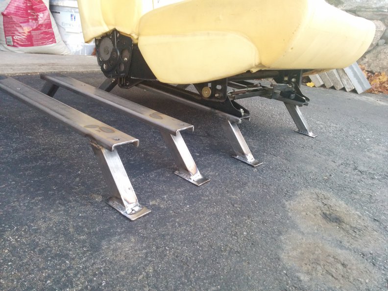

I borrowed a friend’s mig welder and made up some legs for the two front seats to bolt to.

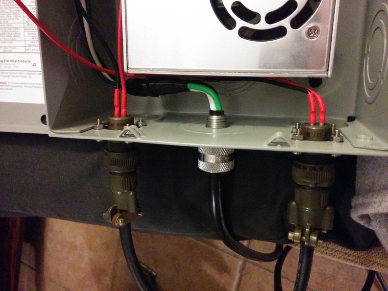

Then I got some original seat heater switches, a 12v 350w power supply, some cabling and fittings and other odds and ends and put it all together in a circuit breaker box.
I used mil spec male and female connectors that thread together for attaching the 12v cables to the control box so if I want to move the seats somewhere else(outside??), it all disconnects.
I’m pretty satisfied with how it turned out since I was winging it most of the time. Arm rests would be nice though…The lumbar works, tilt knobs work, driver’s seat moves up and down in the front and back, and the heat is very quick. I have yet to do anything with the backseat. There’s not much room in my house for it so I’m not sure if I will build a frame for it. I would have to get creative with the frame since the back seat doesn’t have any metal structure on the outside to bolt to.
