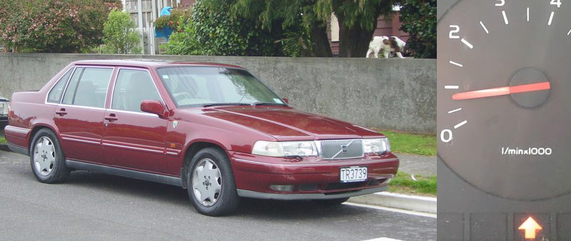

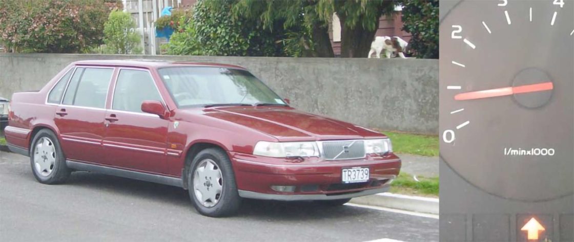

MVS member Bob had the common flashing arrow light on the dash of his 1995 960.
