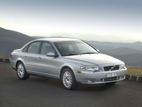

Repair heated seat P2 cars (pics from S80)
