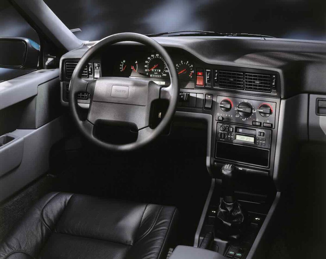

My Volvo mechanic gave me an easy solution to my squeaky dashboard problem. I just did it (took about 1 hour), and it seems to have solved the problem. I’ll post an update next week to see how long term this is.
This is for a 1999 Volvo V70. I think it should work for other models too.
The problem was a loud and annoying squeak coming from the dash on the passenger side. Sometimes it would go away. But then I would hit a bump and it would come back. I tried removing the glove box… no luck. It sounded like two pieces of plastic rubbing against each other. Similar to how a balloon sounds when you rub it. Very irritating!
He told me to tighten up 4 bolts on the firewall. He said that he would bet that I could get a 1/2 turn on each. These bolts hold the dash frame inside the cabin. I ended up getting 2 whole turns. Here is the procedure.
