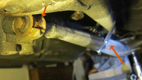

Delta Link Replacement MVS Forums Contributor xHeart: Following photos and notes extends the pioneer delta link write up of Ozark Lee. The project included replacing coil springs, delta…

Excellent write-up with pictures. If your delta link looks anything close to the one here you should replace it. It is quite a task to do it yourself but this write-up shows you how.
