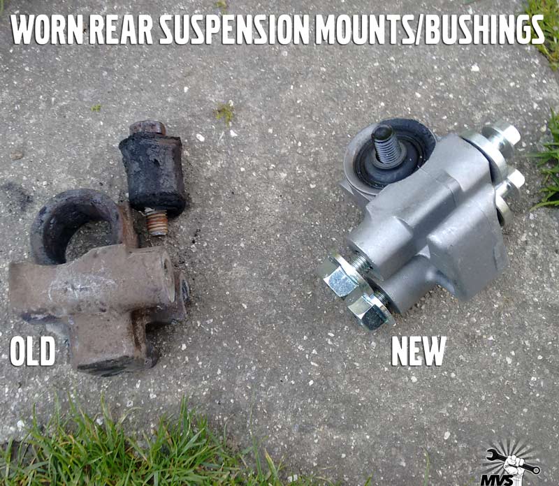

Then today hausmeister reported he’d finally tracked down the problem and solved it with new rear suspension mounts/bushings.
By the way, this is solved, problem were worn rear suspension mounts/bushings.
After replacing all 4 the car drives fine 🙂
worn vs. new rear suspension mounts
