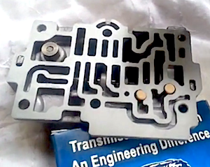

Also replacing just the solenoids is a shortcut which should fix 90% of the issues. In my video I show 2 small piston valves which I had already replaced. These solve some minor issues.
Also replacing all the valve body gaskets will solve minor cross leakage between oil galleys. Before embarking on this journey read all the literature I’ve provided including the Transgo install instructions.
