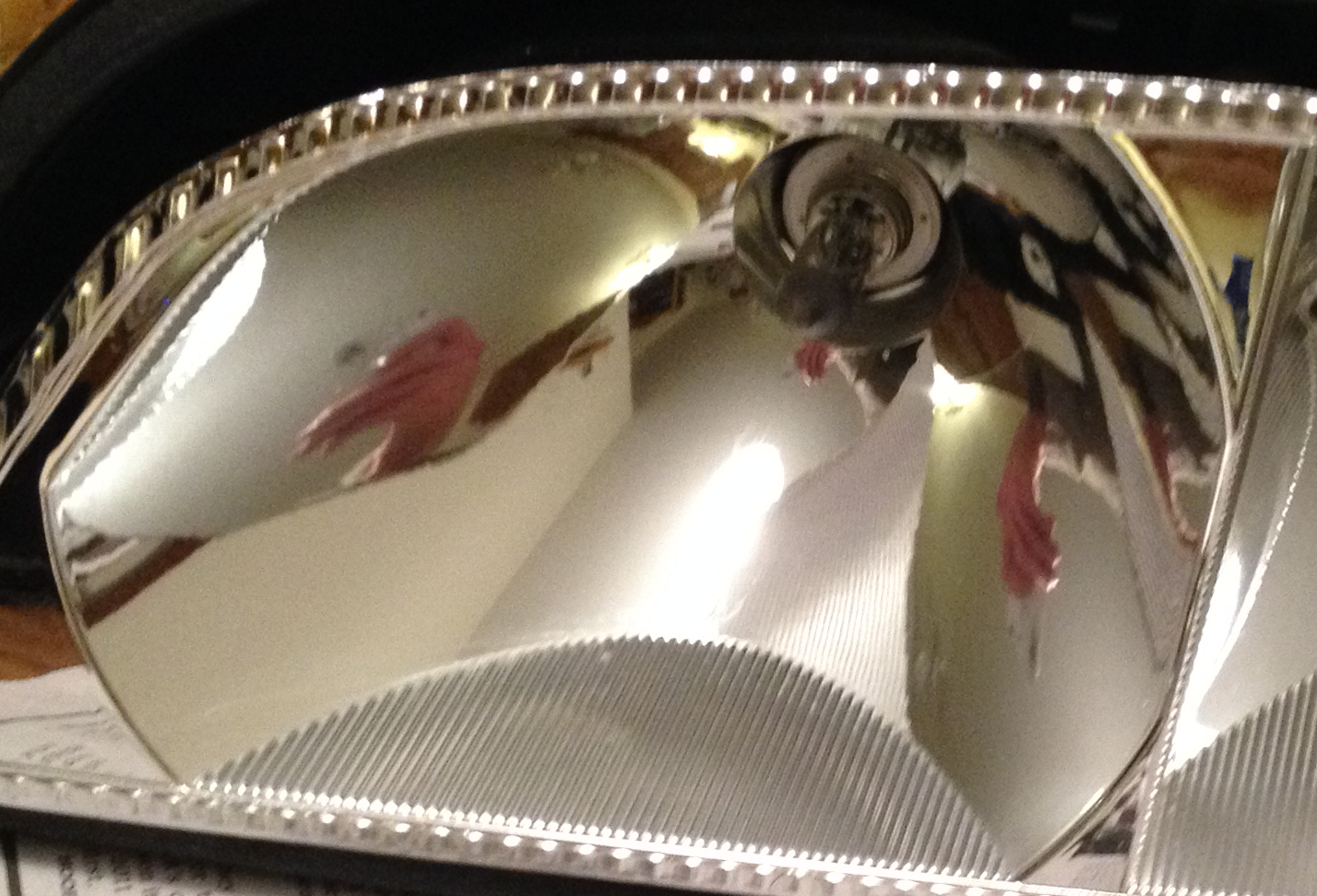

  • It’s surprisingly easy to tell if your headlight is still reflective or not. When I found the good one in the salvage yard, I could look through the clearer parts of the glass and see the reflection. If you can’t do that, it’s likely your headlight reflector is getting pretty yucky.

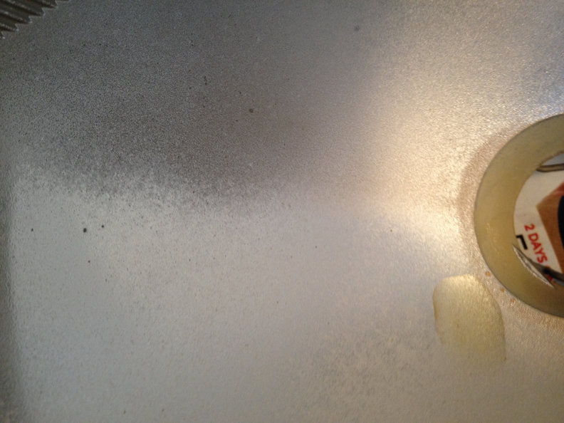

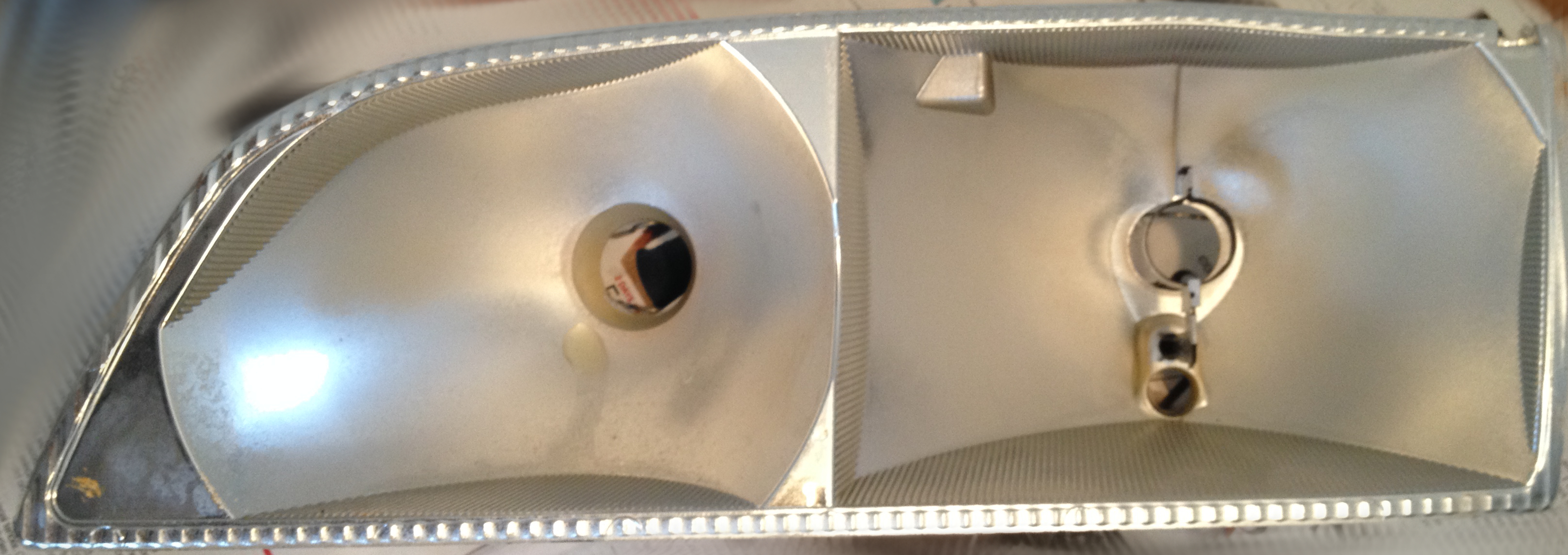

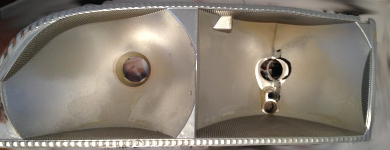

Step #1: Tap water
Sadly, the reflectors are in such poor condition that any remaining residue is difficult if not impossible to see.
Some dirty water accumulated. No degradation noticed to the reflective surface.
In the left corner on this one, you can see I intentionally scratched at the finish to see how fragile it was. It actually took a bit of force to cause that much damage.
If the surface wasn’t already so badly compromised, it’s likely that mineral spots would have been visible afterwards. I noticed them on my new headlight from the salvage yard when I brought it home.
This was from dirty, stagnant rain water though, so maybe distilled water wouldn’t do this?

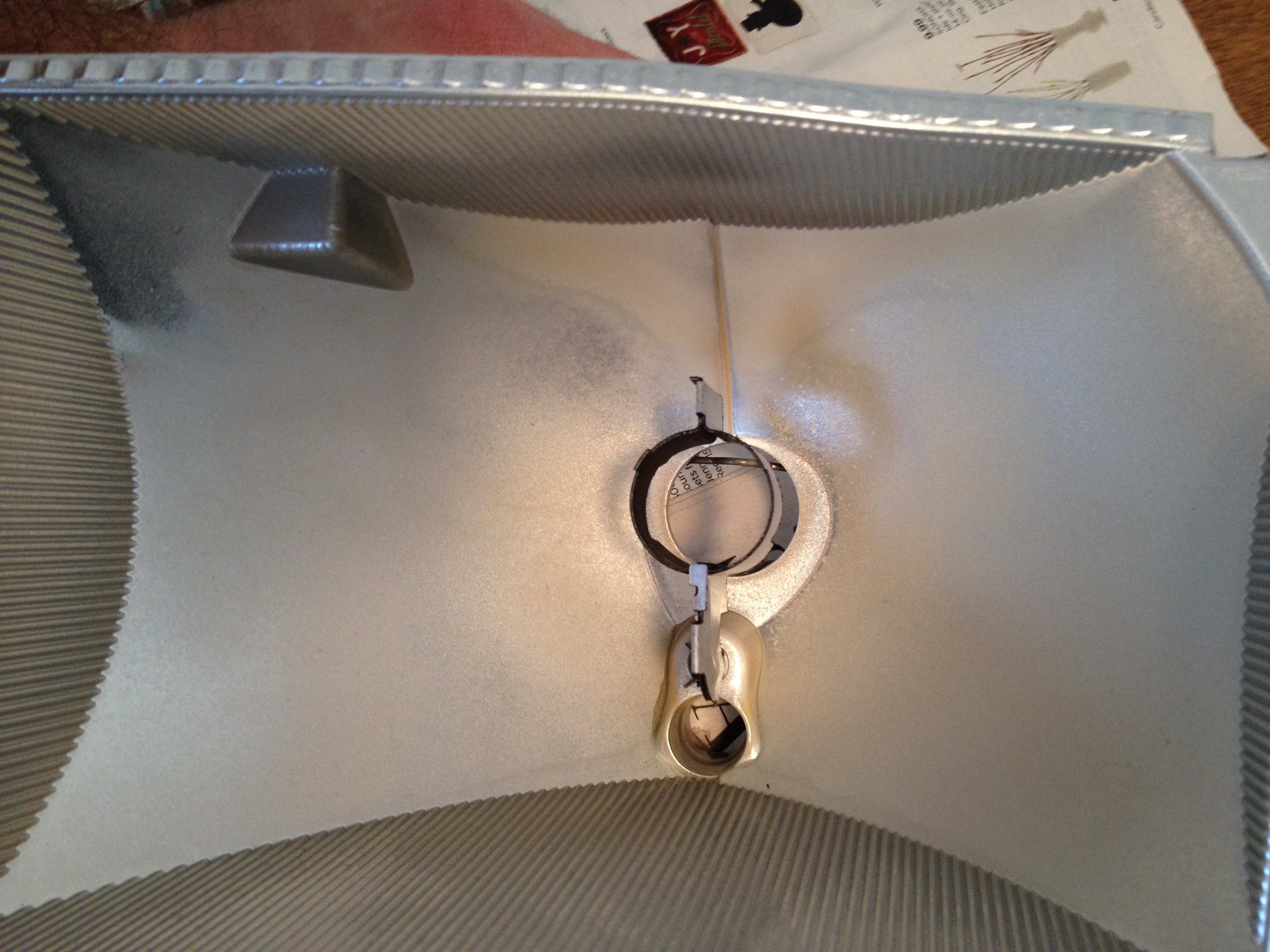

Step #2: Isopropyl alcohol 91%
This seemed to either cause minor degradation of the surface coat, or simply cleaned more gunk off that then spread over the rest of the reflectors.
There seemed to be issues from using the alcohol. At the very least, I theorize that the alcohol was slightly damaging to the finish. Regardless, I would not feel comfortable using isopropyl alcohol straight on a reflector I intended to use. This potential damage becomes more noticeable when comparing Step 1 pictures to Step 3.

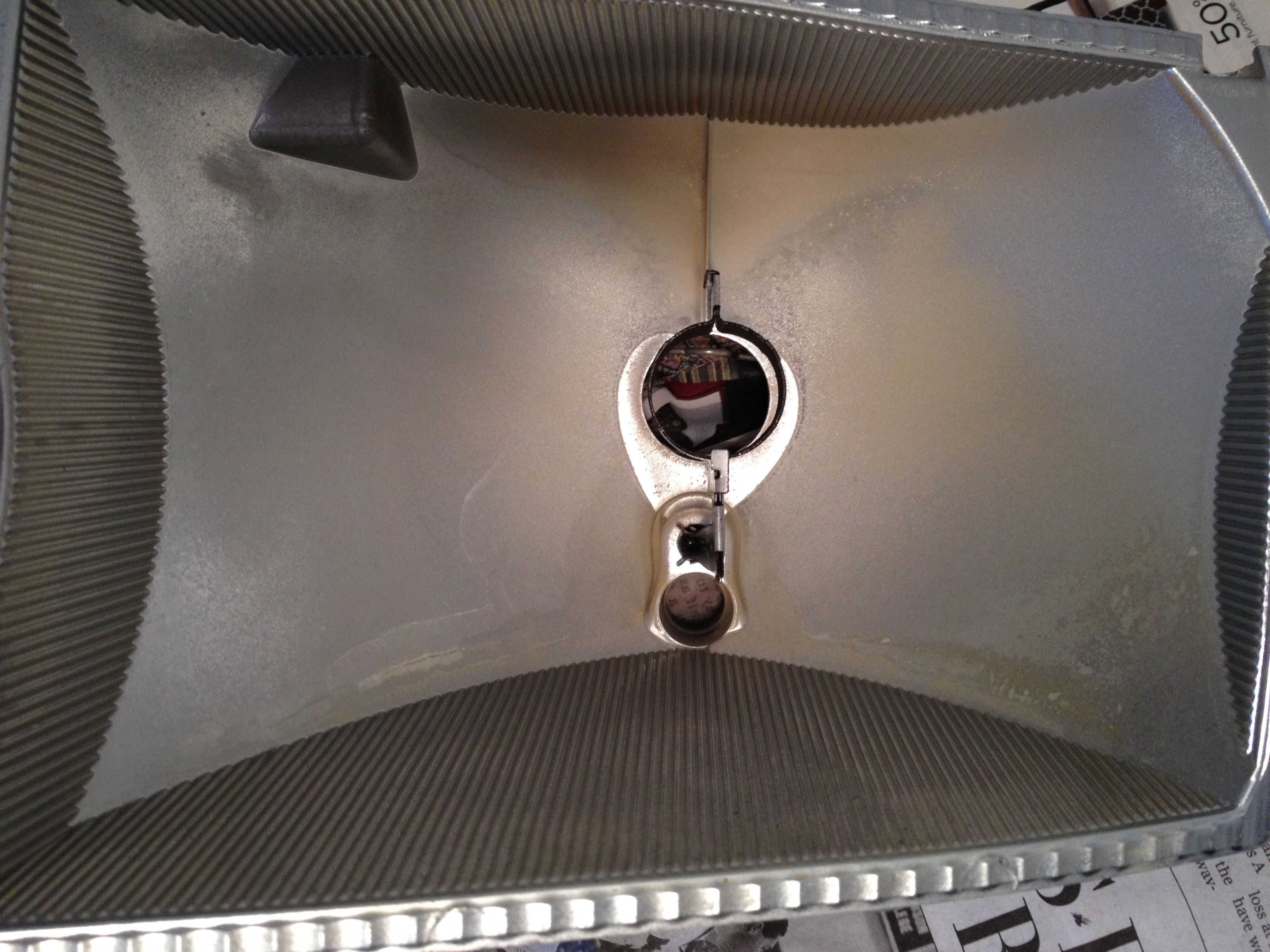

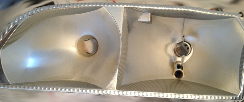

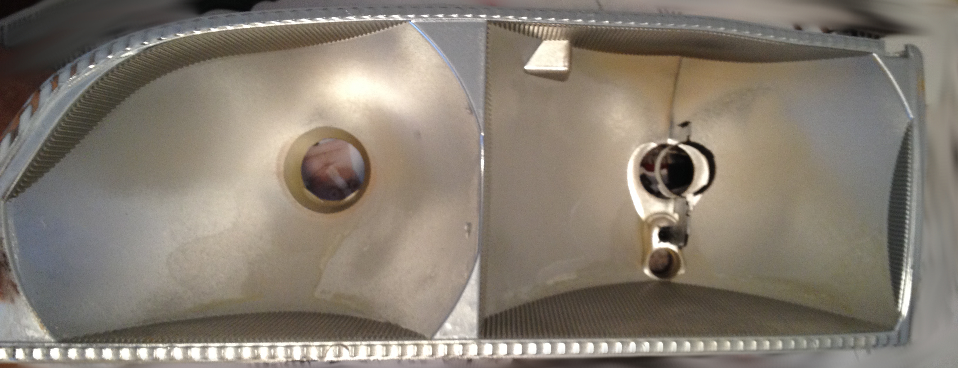

Step #3: Distilled water
Damage is noticeable when comparing a Step 1 picture to a Step 3 picture:
^ Step 1 ^ | v Step 3 v
As stated earlier, I believe the alcohol may have done some damage to the finish, and this round of distilled water just rinsed the lifted finish away.

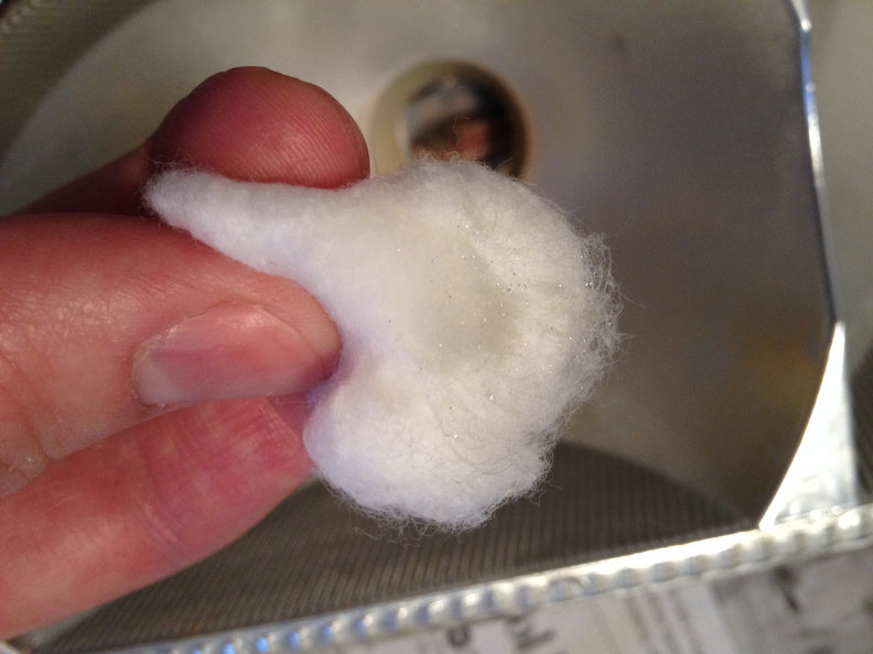

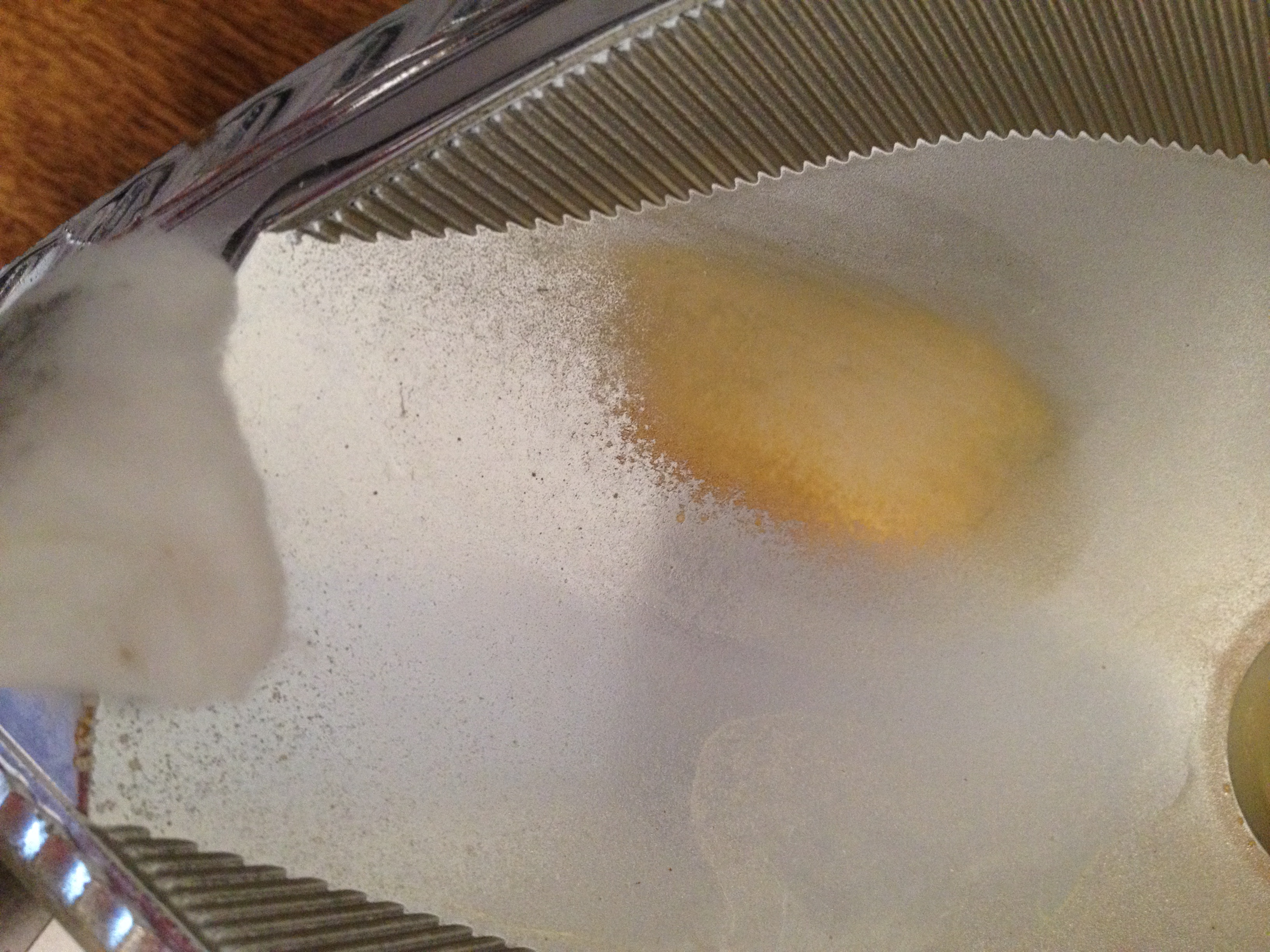

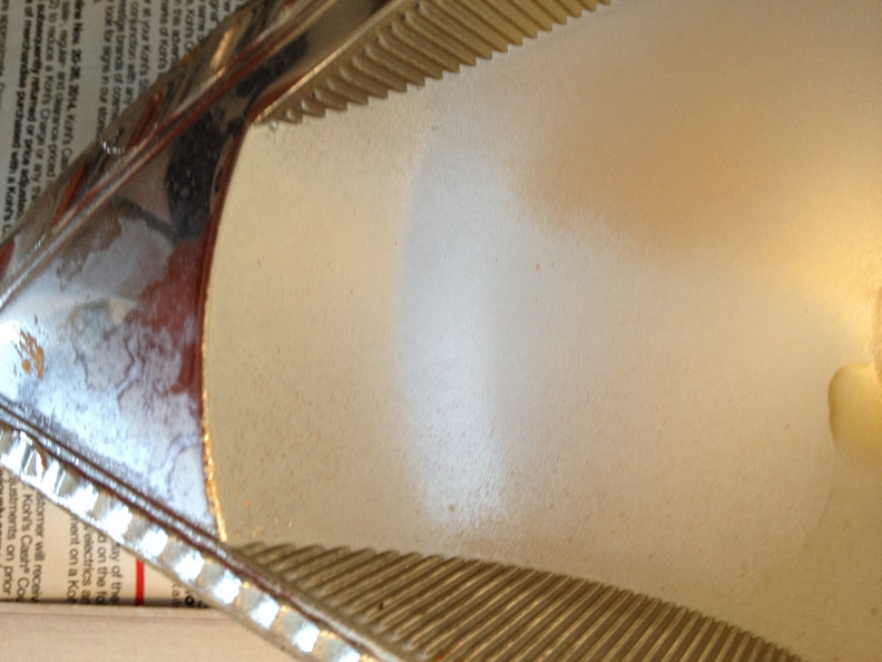

I did some other minor testing. With mild pressure using a cotton ball, I could not see any damage to the surface or residue on the cotton ball (This could be because the reflector was already so old and worn, but I tried this on the parts that were still shiny).
With moderate pressure, however, I would start to notice specks on the cotton ball:
Going past moderate pressure runs the risk of severe, irreparable damage. When I applied moderate pressure and scrubbed, or swiped with heavy pressure, this was the general result:

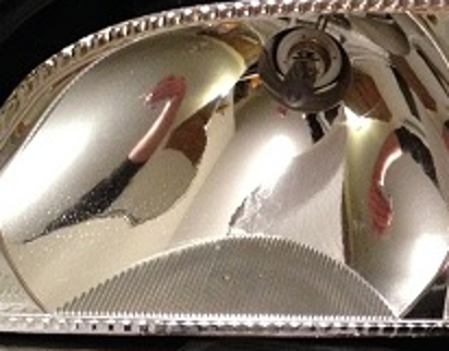

Before and after pictures of the new headlamp.

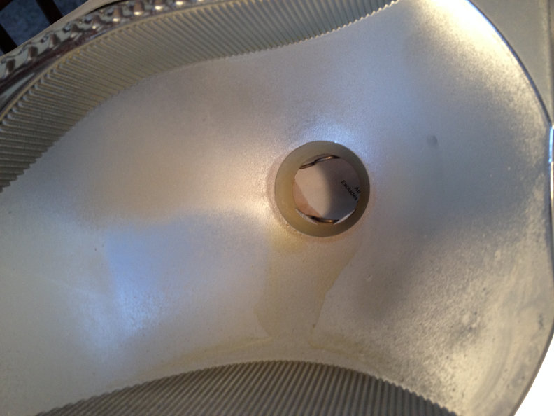

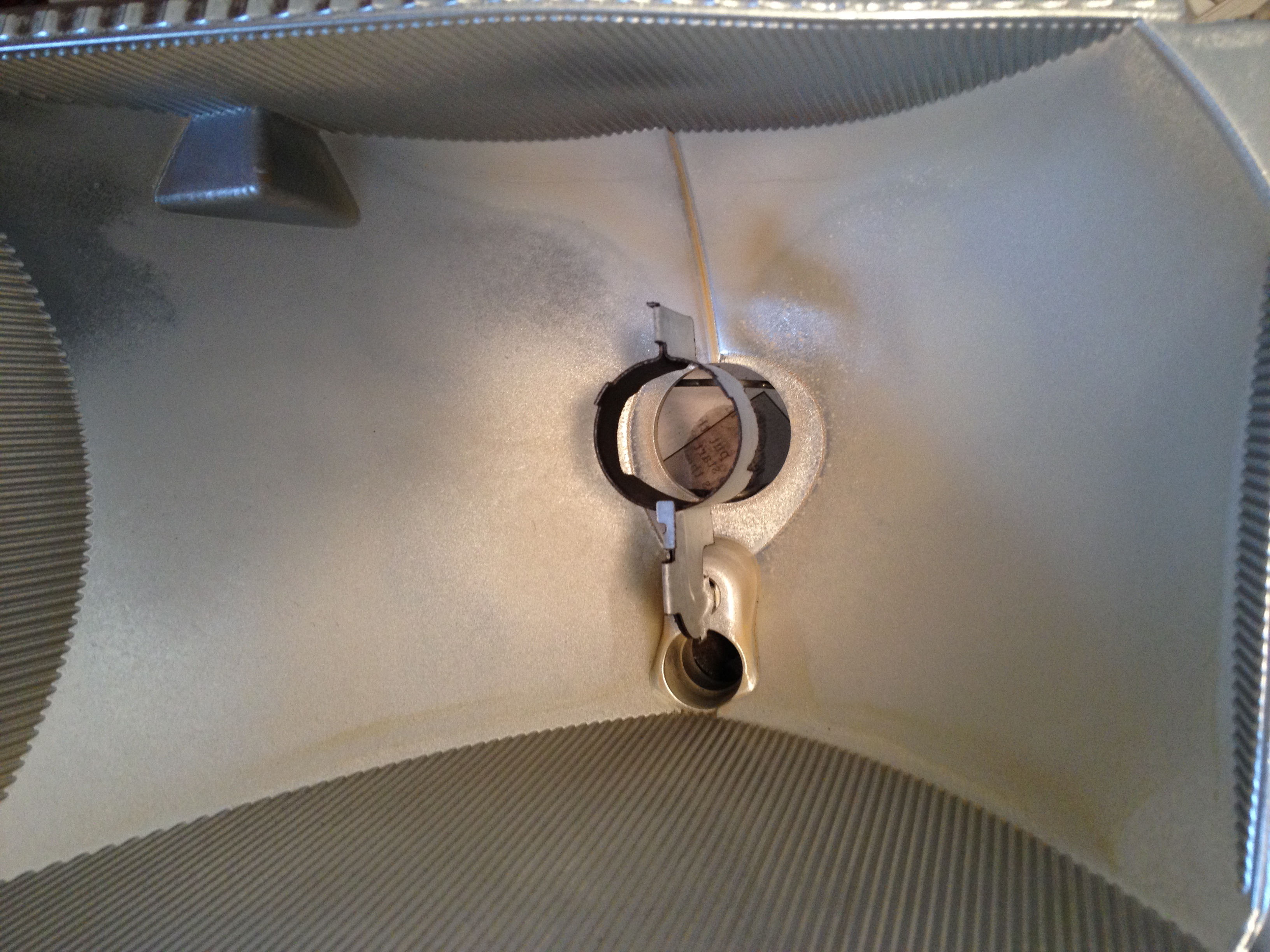

Before:
Obvious mineral spots. Probably wouldn’t have significantly affected the function of the headlamp (especially when compared to my previous one), but I just had to be a little obsessive.

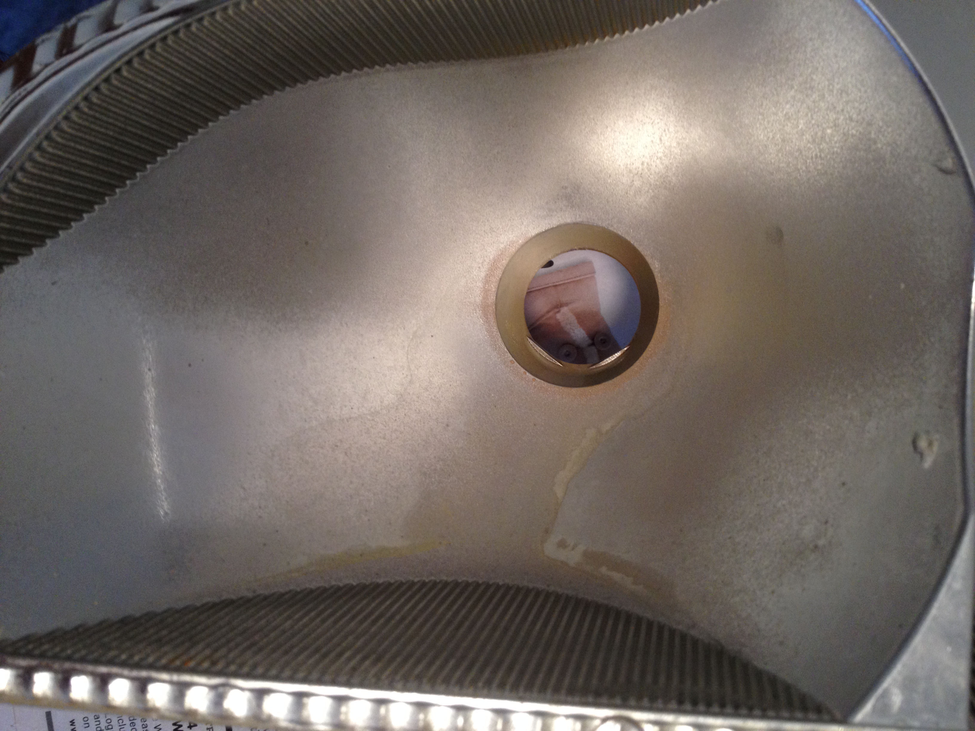

After:
Noticeable reduction in mineral spots, though there is still some staining at the bottom. I decided to let this go and be happy with the improvement I had achieved.

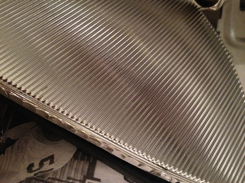

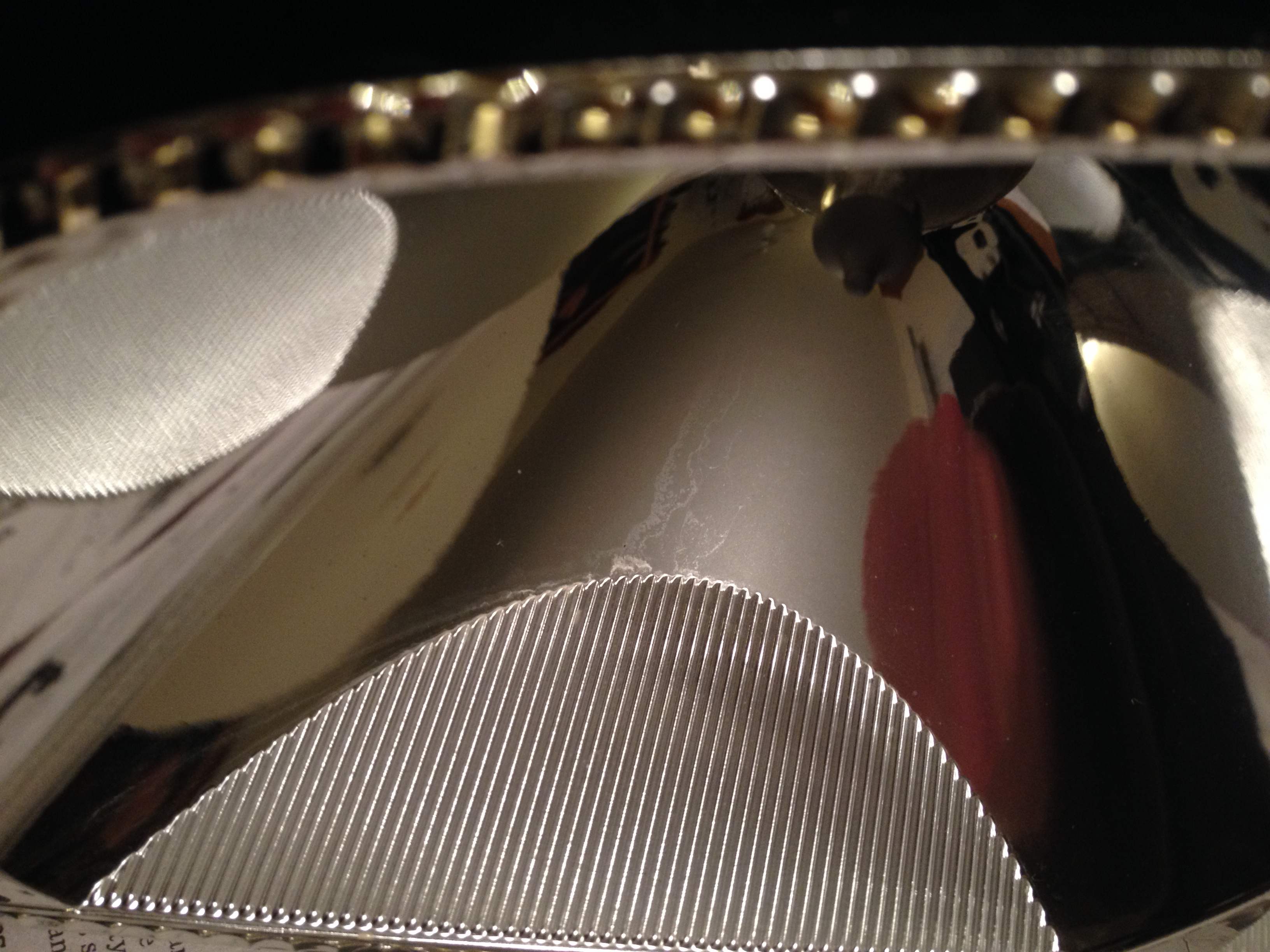

Lastly, I had noticed there was some discoloration, presumably from normal heat/wear, in the ridges that did not seem willing to rinse out at all:
It is clear to me that distilled water would not be enough to restore any kind of shine or clean any discoloration.
