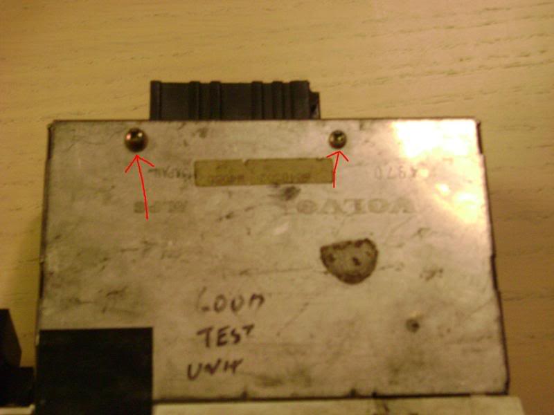

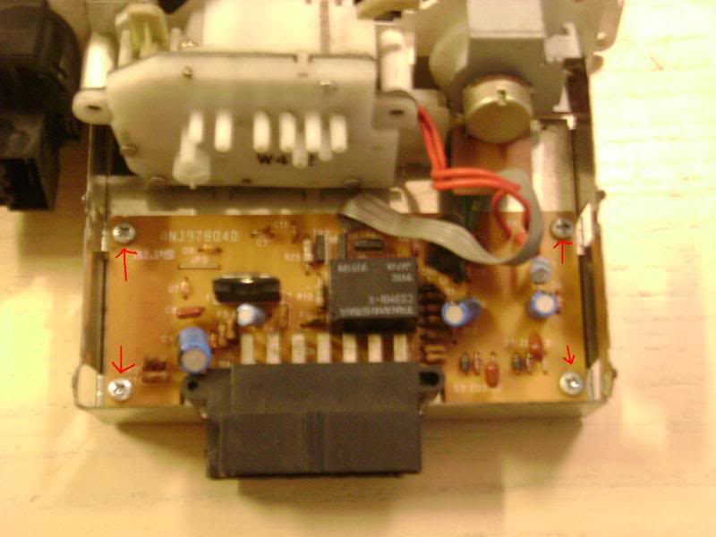

Once you have it out of the car and the black cover off you will see this. Remove the 4 screws the arrows point to.
Then flip it over and remove the 2 screws (Red arrows)

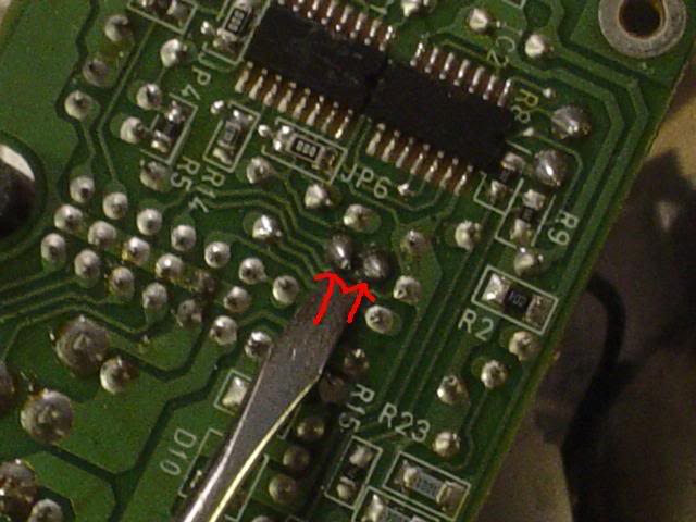

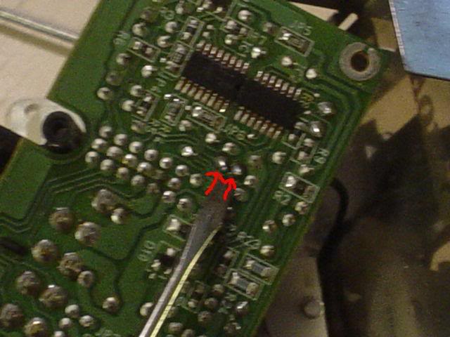

The slide the circuit board out and flip over.
Then check the solder joints that I have the screwdriver by and the arrows.
(Sorry about the quality of the pics.Spend $300.00 for a new camera and pics suck. Use my camera that is 8 years old same brand as new one and quality is a ton better)
Those are the joints that normally go bad.

Just repaired the ECC unit on my 92 940. compressor would not run. Examination of the ECC board revealed a dry joint on the Pressure controller switch. Reran the solder joint, presto the AC works fine.
