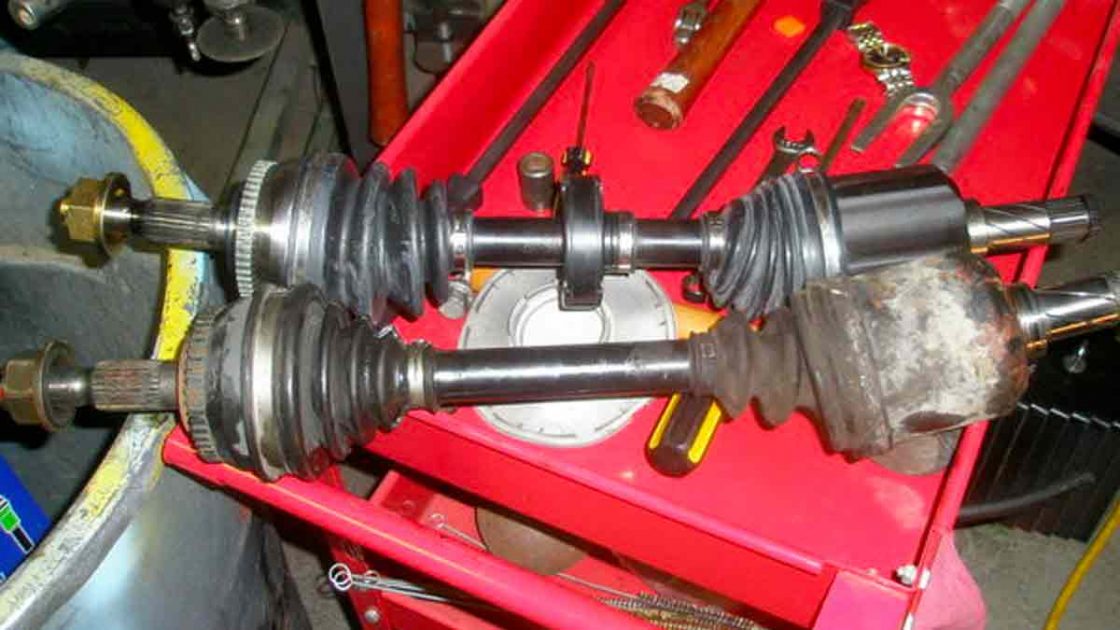

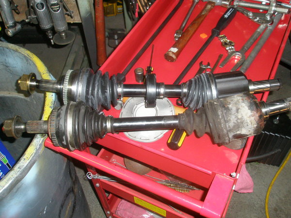

I purchased new axles for my daughters ’95 850. I got them from FCP. As you can see the new axle at the top of the photo has some sort of “disk” in the center of the axle. I don’t know what it is. Every thing else looks the same except for the inner CV joint. The casing is shaped differently. I made the mistake of pulling the old axle out before getting the new one out of the box. I needed to get the car back on the road and all other things being the same I put the new axle in. I’ll be calling FCP tomorrow but can’t stand the anticipation.

I puchased new duralast gold axels and they are considerably different than what are currently on my 95 850 turbo. the shaft and nut on the existing are considerably larger than the duralast ones but I cant seem to find the ones to match mine. I havent yet removed mine completely but I guess I will so I can compair them more closely, unless anyone has a better suggestion.
As long as total length, offset of inner & outer axles, spline size and number are identical I’m sure they’ll be OK. I’d be more worried about what quality and quantity of grease is IN the boots as this is a known issue with non-genuine shafts.
There is a TSB….. TP 4305201, Section 4 (43) AW50-42, 850 Auto Transmission, 1992 – on
“In certain cars with auto trans a high frequency whining sound may be heard from the final drive at approx 55-60km/h (34-37mph). The sound is most evident when the trans is warm and the car is operating at low engine load”
I had this part fitted under warranty (vibration damper 9181745-2)on my “96 850 but they became production fitted on AWD and Turbo models.
Valvster
Its to help absorb vibrations in the shaft. I work at a small private volvo shop. I think all the axles we install have them on them.
