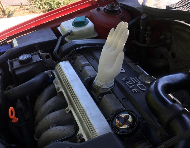

- Oil cap fill location failed the rubber glove test (checked because of oil leaks).
- Glove filled up with air.

- The PTC nipple is clear and the valve cover now has great vacuum (does not fail the glove test).
