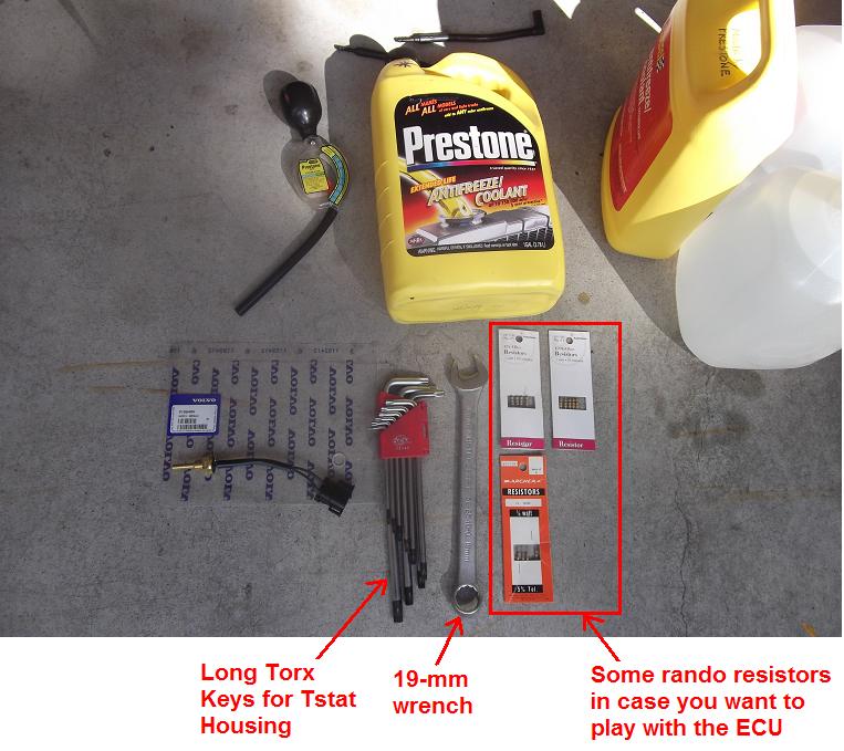

Tools
* Coolant
* T40 Key and 19-mm Wrench
* Some random resistors in case you want to play with the ECU.
